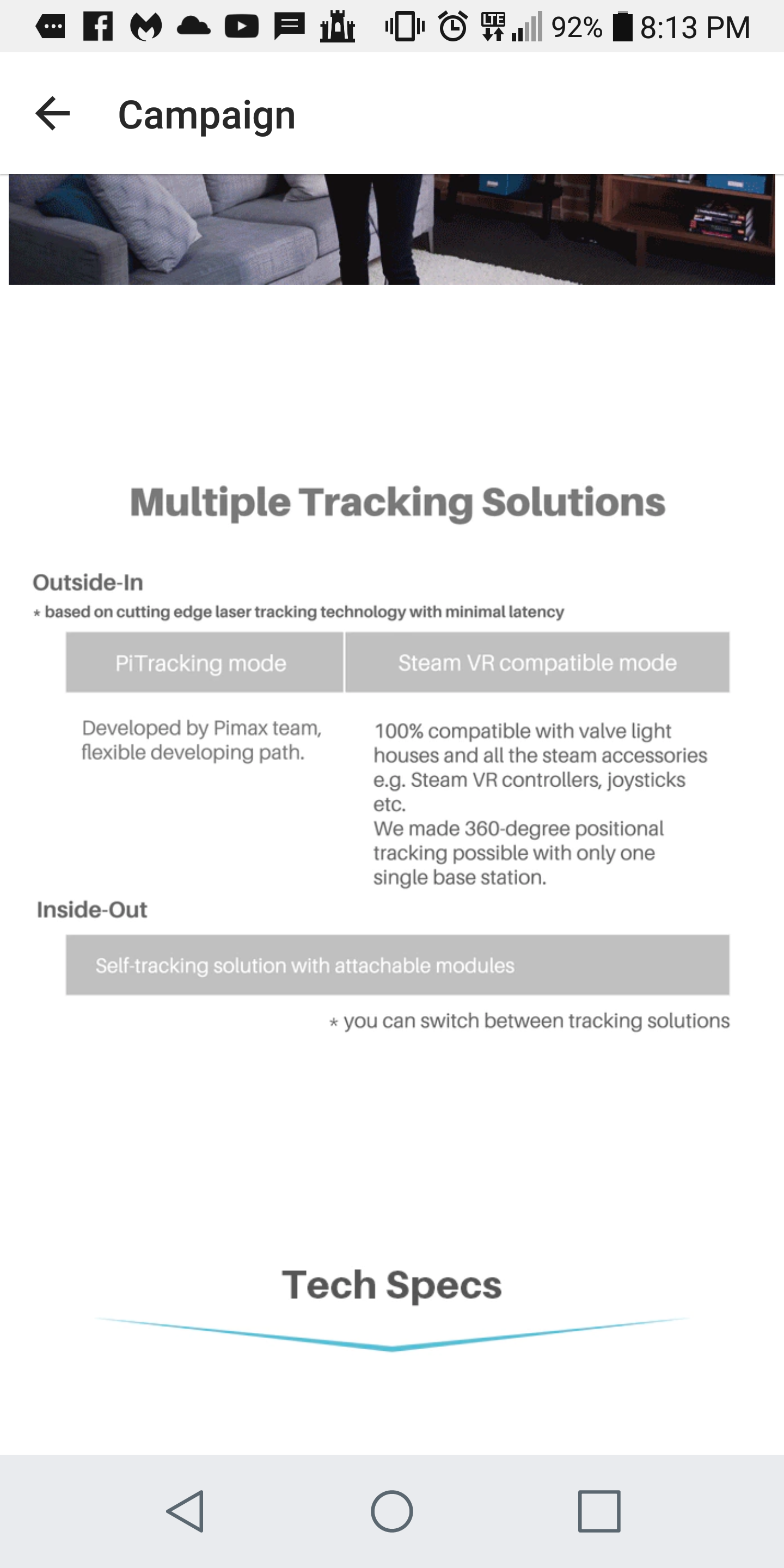

Do we know this?
Neither the Vive or Oculus can be used without trackers. I’m not sure pimax will.
I would assume the 8k requires at least one basestation.
We know this because the hand tracking module cannot be used with Steam tracking; they are not compatible.
& pimax has said steam tracking & pi tracking; its not limited.

Okay the leap correction. However it seemed you were confused that the headset couldn’t function without a base station & like the 4k it can.
I am a bit skeptical about this point. While Pimax 4K did not have any other choice so it had to implement some sort of position tracking using MEMS, apart from short notice on KS page, Pimax 8K (or 5K) was never demoed without lighthouses.
