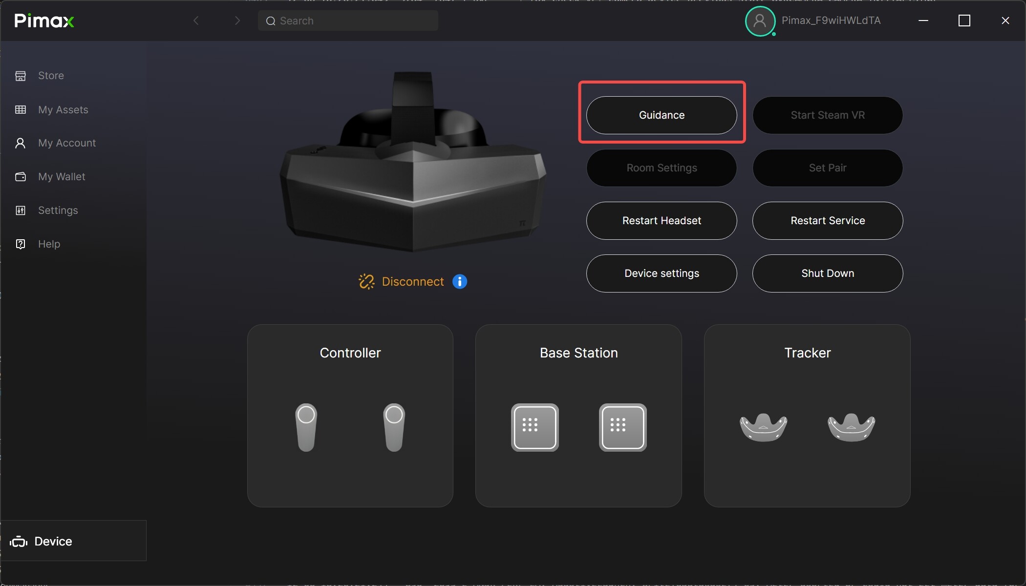

sorry, I should not have used the word “guidance”, as I’m not talking about this button;
I’m talking about the inside headset schema that help to align the headset to the eyes when you firstly put the HS on the head.
I don’t have it anymore, it is jumping directly to the IPD auto setting.

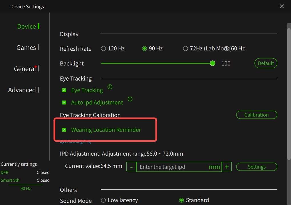

Ahh,
Did you enable the wearing location reminder?
Is that the on/off for the alignment guide?
Indeed, activated this feature restored the alignement help.
Not sure the title of this feature is the most accurate for this…
For very thank you for this clue.
