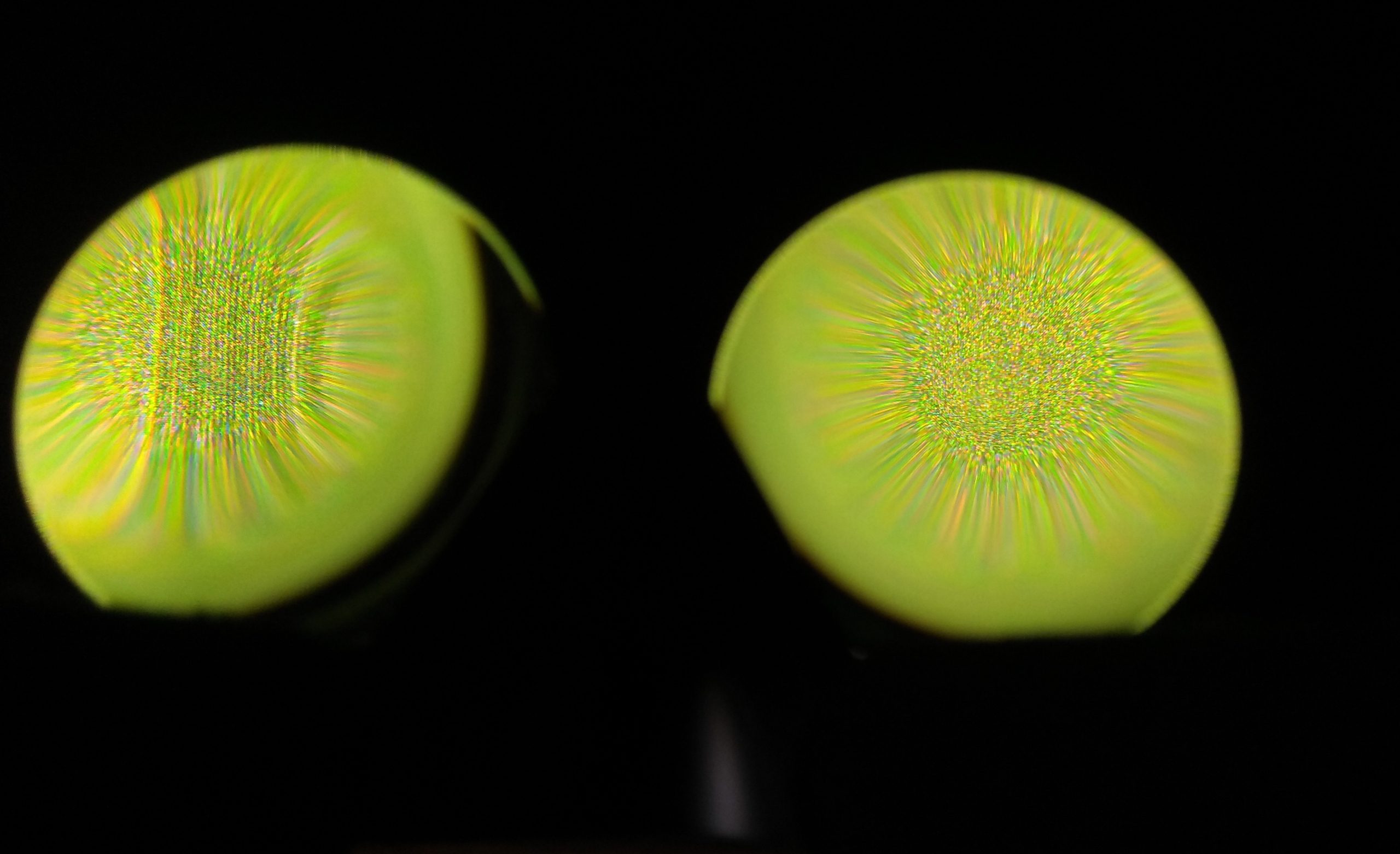

Well sadly I think I’ve given up
My Pimax 4K now just shows a green LED and no display despite Piplay and Pitool confirming that the HMD is connected.
I’ve tried replugging the USB and HDMI cables, I’ve tried disconnecting other monitors connected to the GTX1060 apart from the main monitor.
I still don’t understand what changed since it worked correctly but it means I’m now VRless until I can afford a new HMD
I guess my Pimax 4K has finally died, unless a Pimax guru can advise otherwise.
This is the display I now get, still plugged into HDMI on my GTX1060 and a powered USB3 hub.
