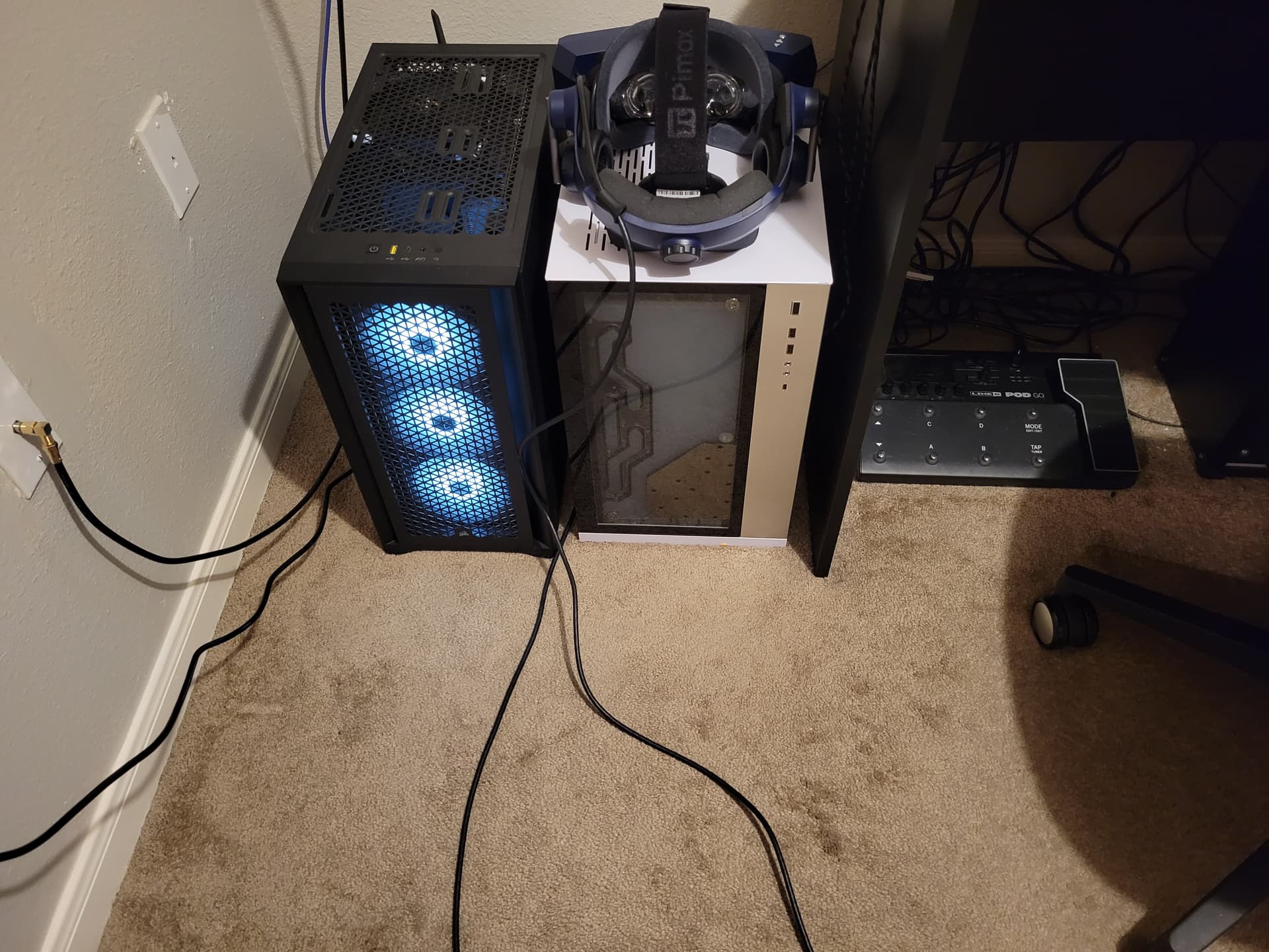

heyo ima need some help. support gave me firmware
P2_DEBUG_8KX_N7_0_M2001_t20220527113650_rc879f9b_90Only_Duanlian_sub0527.dfu
to flash to my headset. I flashed the headset and now it atleast turns on each time but I get bad artifacting on my right eye only. whats goin on? this firmware cant be the same as the one that came with my headset. i didnt have this issue before.
I sent an email to support on the issue. And it is confirmed to be happening on both my original cable and the optical cable. so its not cable related…
alright im gonna have to pull out my rtx 3060 media pc with known good usb ports and amd 3600x instead of a 12900k. this pc is rock solid stable. if this doesnt fix the problem then i will wait for a response from pimax.
update: on two different systems with two different cpu manufacturers and two different gpus and two different cables I get the exact same artifact on the right eye… i give up. this must be related to the firmware i received from pimax support because this was not happening before.
i’m an engineer so i know how to diagnose stuff pretty decently. went into the forum and found two different firmwares for the 2001 version of the 8kx. version
P2_DEBUG_8KX_N7_0_M299_t20211203180915_rc879f9b_90only.dfu
is supposedly the firmware that ships with the headset and is confirmed to not be 299 but is in-fact 2001. this solved my artifacting issue perfectly. however… the headset does not always turn on when the power putton is pressed and pitool is open. these are the same issues I had before. so I got things from this experience.
the firmware pimax support gave me fixed the headset not showing up on every power button start. but this firmware introduces artifacting in both eyes.
the audio issue I was having before was related to firmware wanting 7.1 surround for some dumb reason
pimax needs to fix the headset not always turning on when needed. this is a MASSIVE issue. you need to restart the headset about 3 times in order for both the headset and displays to turn on. there is an issue where the headset is on but the screens do not initialize.
