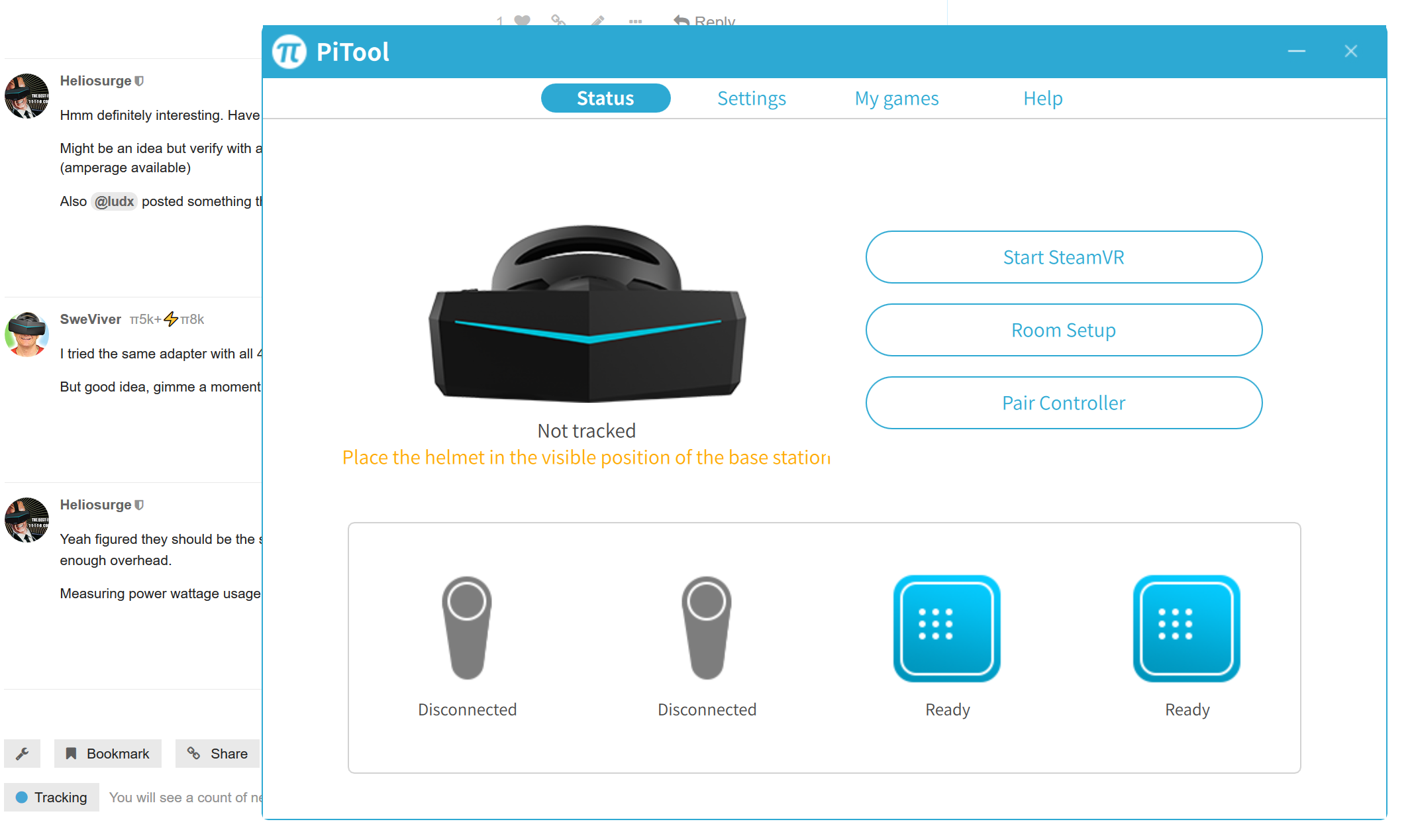

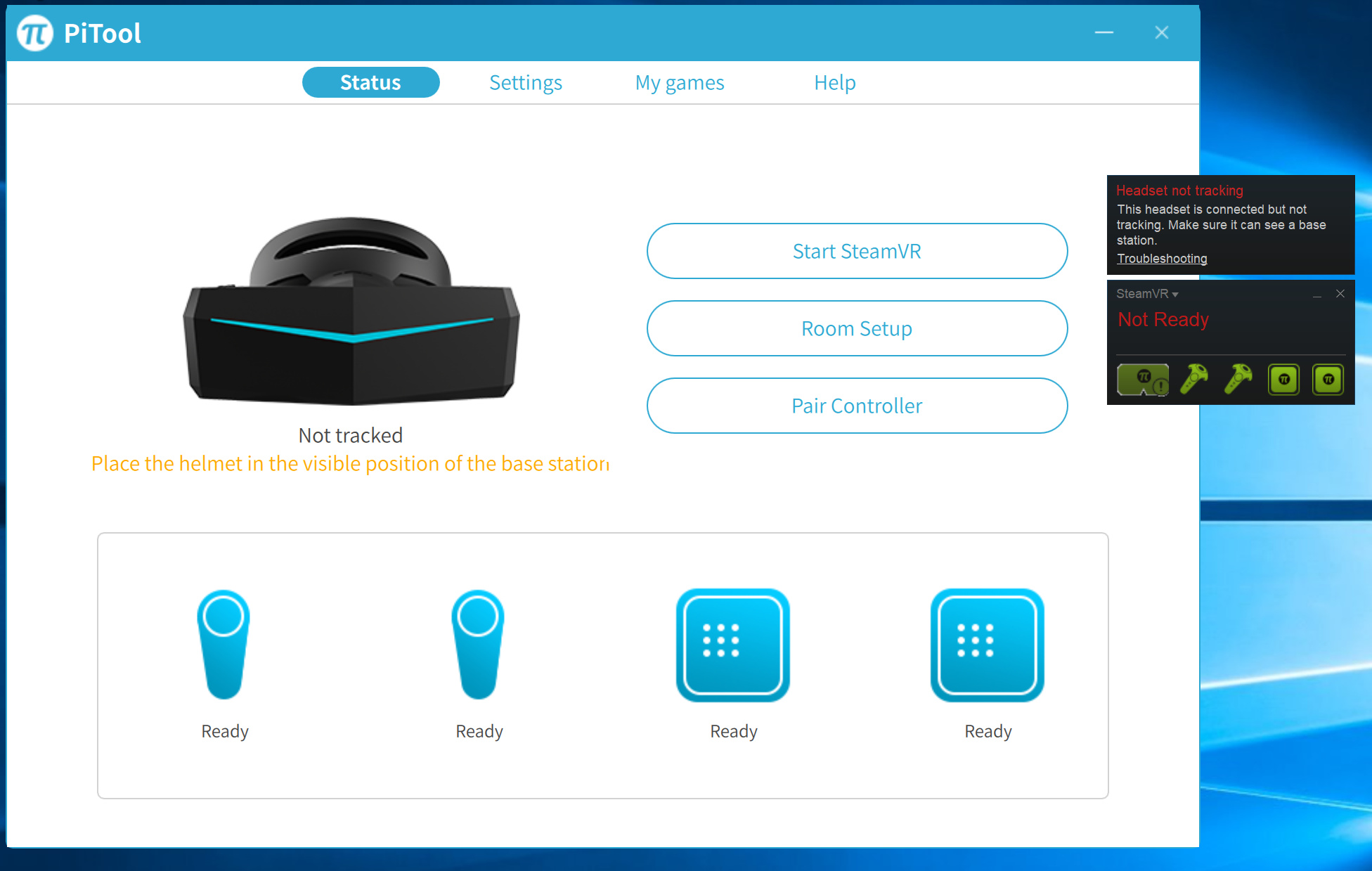

On the new 5K+, it always says (in PiTool): “Place the helmet in the visible position of the base station”.
Check the screenshot:
The image inside HMD goes instantly grey when started.
This is everything I have tried so far:
  • I have tried PiTool 90, 84 and 76 and same problem on all versions.
  • I have tried flashing the firmware with both DFU.exe and the old DfuSeCommand.exe method and both flashes successfully but tracking problem remains.
  • Turning off “Turn on Lighthouse tracking” option works ok, I can use SteamVR without positional tracking and image is OK, but as soon as I turn on “Turn on Lighthouse tracking” the headset goes grey and problem is back.
  • I tried switching the cables (tried 3 different Pimax cables, same problem with all).
  • Same problem on RTX 2080Ti desktop PC and also my GTX 1070 laptop
  • I tried using 1 and 2 basestations. Same problem.
  • Tried EVERY USB 3.0 and 3.1 ports on my PC and laptop, same problem
  • Tried all DisplayPort ports on my desktop PC, same problem.
  • Connecting the 8K to same PC works great - no problems.
  • Connecting the “old” review 5K+ unit works great - no problems.
  • PiTool Diagnose shows everything is OK:
