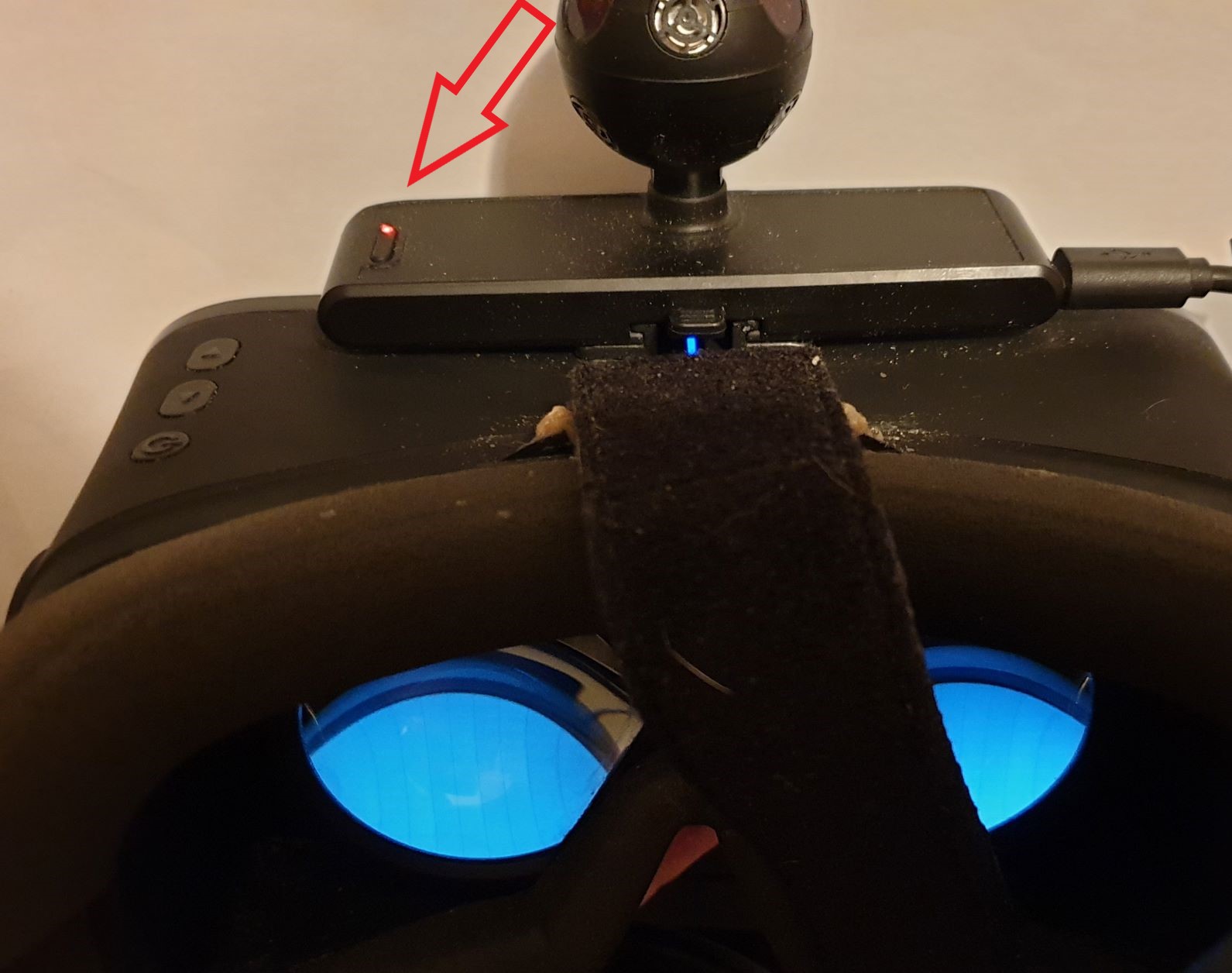

What is the condition of the LED on the headset tracker?

The headset LED is blue. I can actually use the headset in VR as long as the Nolo is unconnected, so I think the headset itself is fine.

is the LED of the Nolo Headset Tracker red or green?
The LED is green. I’ve paired the components a few times since I got it.
is the led switching to red, if you turn off the lighthouse station?

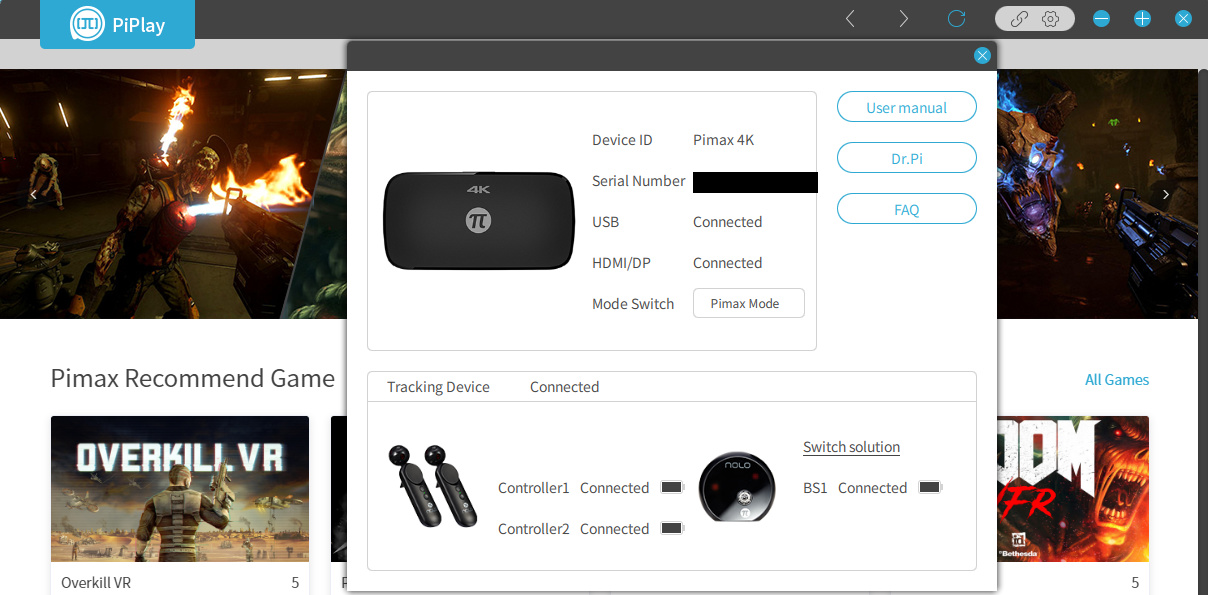

I’m not at home right now, but as I remember it the Piplay displays 2 controllers and one device as connected, the 4th one is not connected. I don’t recall specifically any headtracking status in Piplay, but SteamVR definitely reports not tracked.

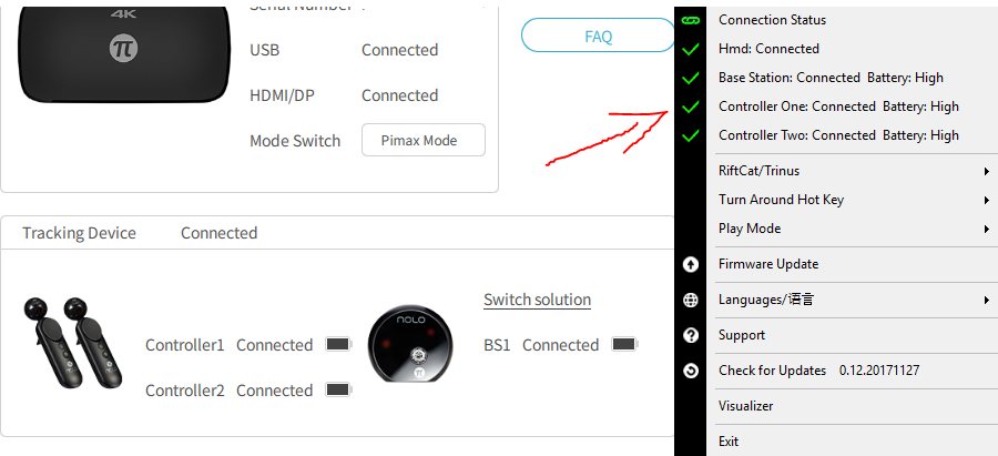

The download contains Nolo_driver_for_windows.exe which is a Windows tray tool. It shows you the connection status as well (need about 10s after booting) and e.g. starts the fw update tool. With the visualiser option you can test the Nolo tracking independly from Steam or Pimax Tools.
I have Piplay and the Nolo tool both installed at the same time and I have no issues. I can even run Piplay and Nolo driver for windows at the same time and both show active tracking.
Thanks for the image. I get green lights all the way, apparently all is connected. But, still no tracking. The visualiser tool displays something that looks like tracking, but I think is only showing internal gyro positions. I think this because I can move the controllers & headtracker around and they only rotate, and even when under my desk (out of sight of the base station).

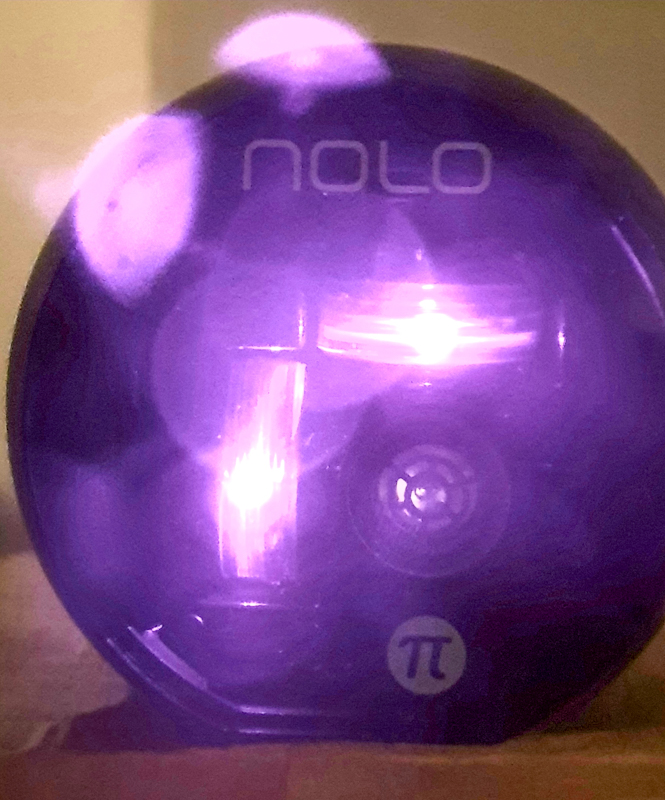

I don’t get any lights on the front of my base station.

Regarding the lights of the Nolo Basestation, you don’t get the red leds on the front? Did they appear in the past? What is the status of the led on top (powerswitch) and do you hear the tracking noises which were send by the base station?
No lights on the front. I never saw any, and I didn’t know there was supposed to be lights, so I didn’t pick up on that large clue :slight_smile:
The power light comes on, I can feel something spinning inside, but there is no lights and no noise (other than the slight buzz from the spinning). And all the devices light solid green.
But in any case, the techs over at Nolo support recommended I replace the Nolo system from where I bought it, as it’s faulty. So that’s what I did this morning, after work I will try it out & report the result here.
Yep it looks like a HW issue of the base station. Normally there should be 2 red dots visible. If you check it with a camera you see thats actually IR LEDs.
