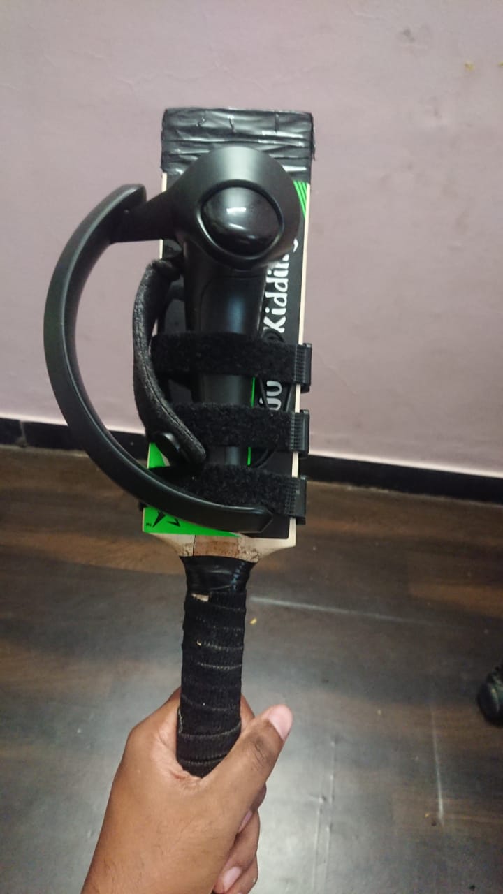

Currently, I am using the velcro straps to fit my right knuckle controller on cricket Bat to play in VR but it’s a real pain to get that controller free from that Bat and then align it again in the same way as before so that is the reason I am printing something like this below so I can easily get OUT and IN the controller whenever required
This is the current solution below which I am using with the help of Velcro straps but I don’t like it much.
