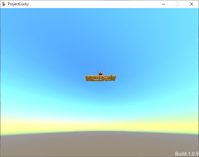

Oculus game
Today lucky tale can’t play
And one problem, the height always wrong and when I want to use openvr advanced setting to set the new height, I can’t use systeam button to open dashboard, the game will always go to steamvr home instead.
@Sean.Huang
try by revive instead, have same problem then try to oepn oculus and get alert.
May try again.
Edit : Can be play right now after oculus can be opened .
Solution : adjust room setting in PiTool to be around 90 and can play this game.
