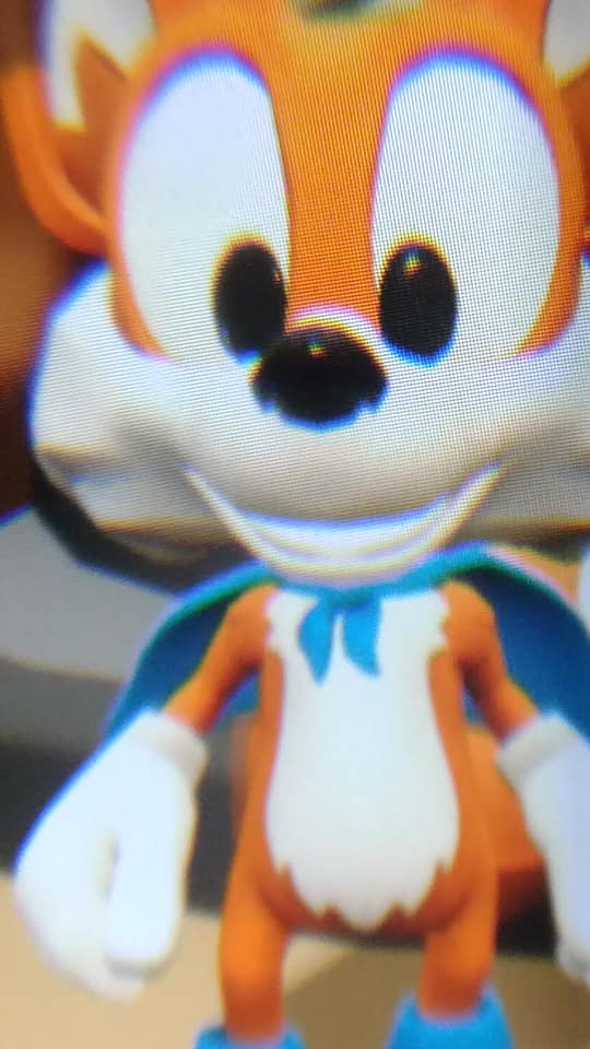

I just get my 5k+ and this is my review and my test (english is not my language, don’t be serious about wrong grammar).

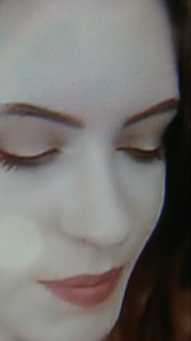

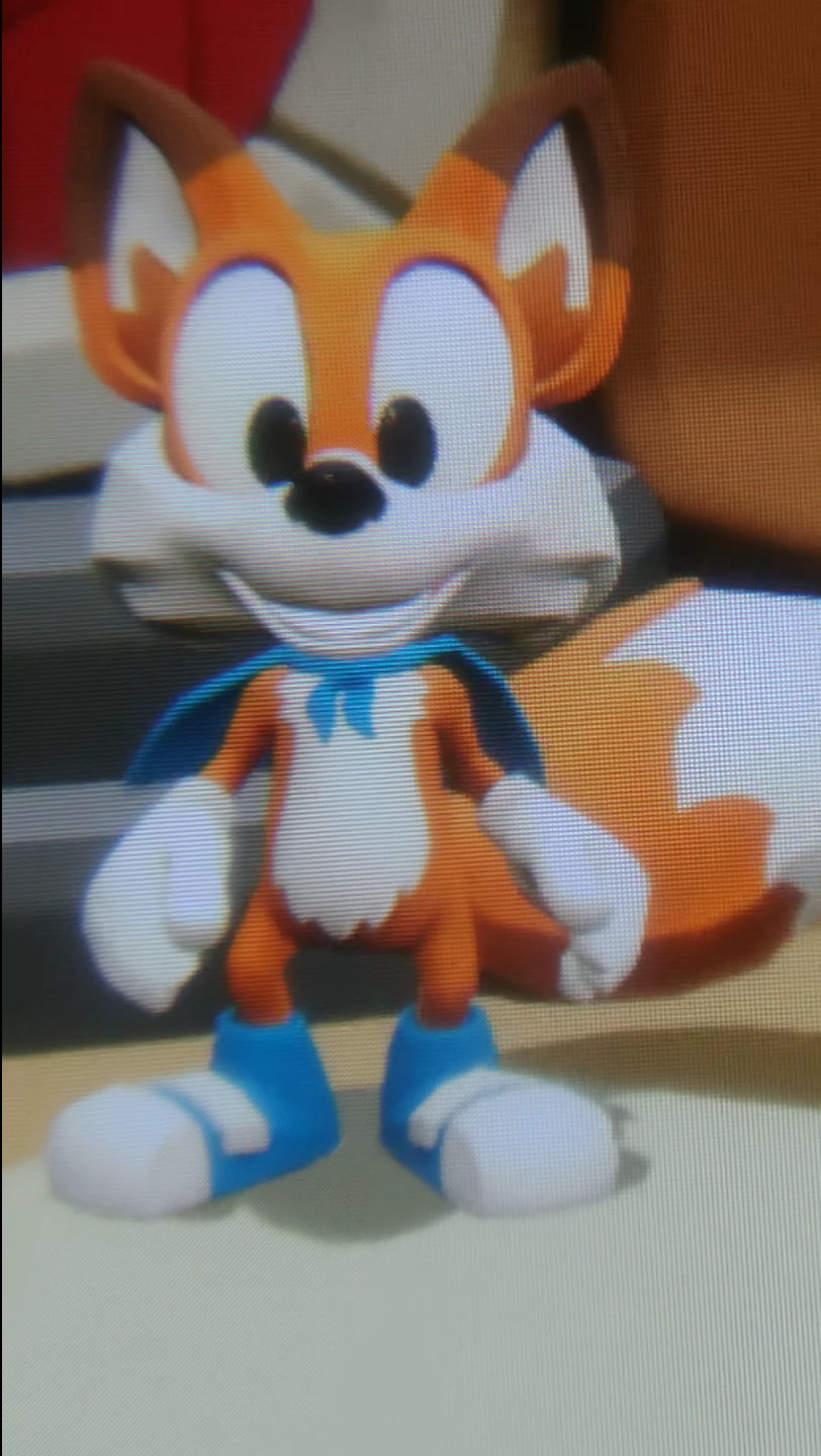

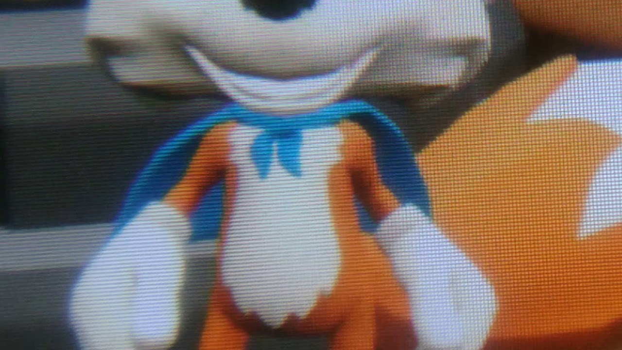

- Your naked eye can see the pixel size like this.
Shoot by zte axon7, 20 millions pixel and zoom x4.
In my opinion, not different too much from oculus go or any mixed reality headset (feel same).
You can see black dot pixel whole the display easily until you focus on the game.

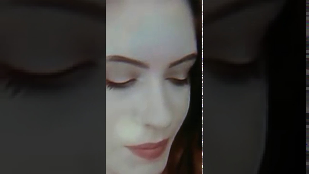

When I turn my head, I will see more bigger line like the second image (still not sure that because my pc is low spec or not)
Edit : when I test to look around without turning head, I think this is normal SDE which be bigger or easily by some color bg.

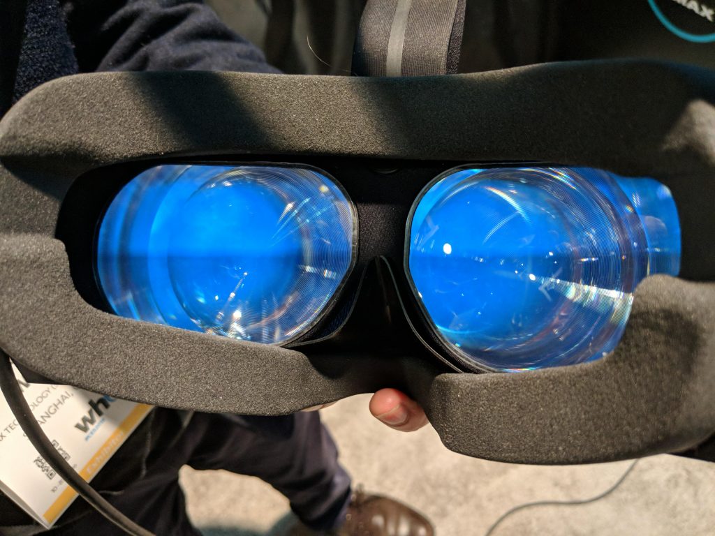

- Inner distortion, I try to adjust the maximum IPD and found that there is some space between lenses, when I use bobo vr z4 (cardboard), you can see the image by this hole by different eye and so you can see some distortion at the edge (because it is low fov headset). But if you can see image by this hole, you will see the distion at the center instead because it has bigger fov.
After I adjust the maximum IPD, I try to close one eye and other eye still can be see this inner of other lenses, so try to use your finger to insert between space and nose for blocking image in opposite lenses (not sure because I still not found inner distion too much, but see sometimes).
