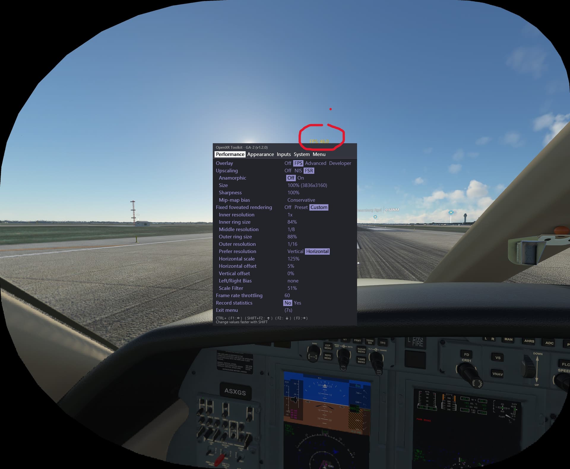

Settings here:

I would like to Share this with the Community, as I have achieved 46-55 smooth FPS with my 8KX in MSFS 2020 with some decent visuals.
You also can gain another 5-6 FPS if you set your monitor to Native mode. No HD or G-Sync.
What I would like is for someone, when they have time is to duplicate my settings on your system and see what you get.
I am still having a problems understanding how FFR works in OpenXR Toolkit. Need help with some of them settings.
Also I would like some input on the in-game settings in VR as I only Fly in VR and not in 2D.
My computer system is on the GeForce Experience Photo and I do run GeForce Exp.
I am using a Fiber Optic Cable and USB Power HUB.
I sure hope I help someone out as it’s been a long year, but now it’s worth the purchase.
Have a Super Day and stay safe.

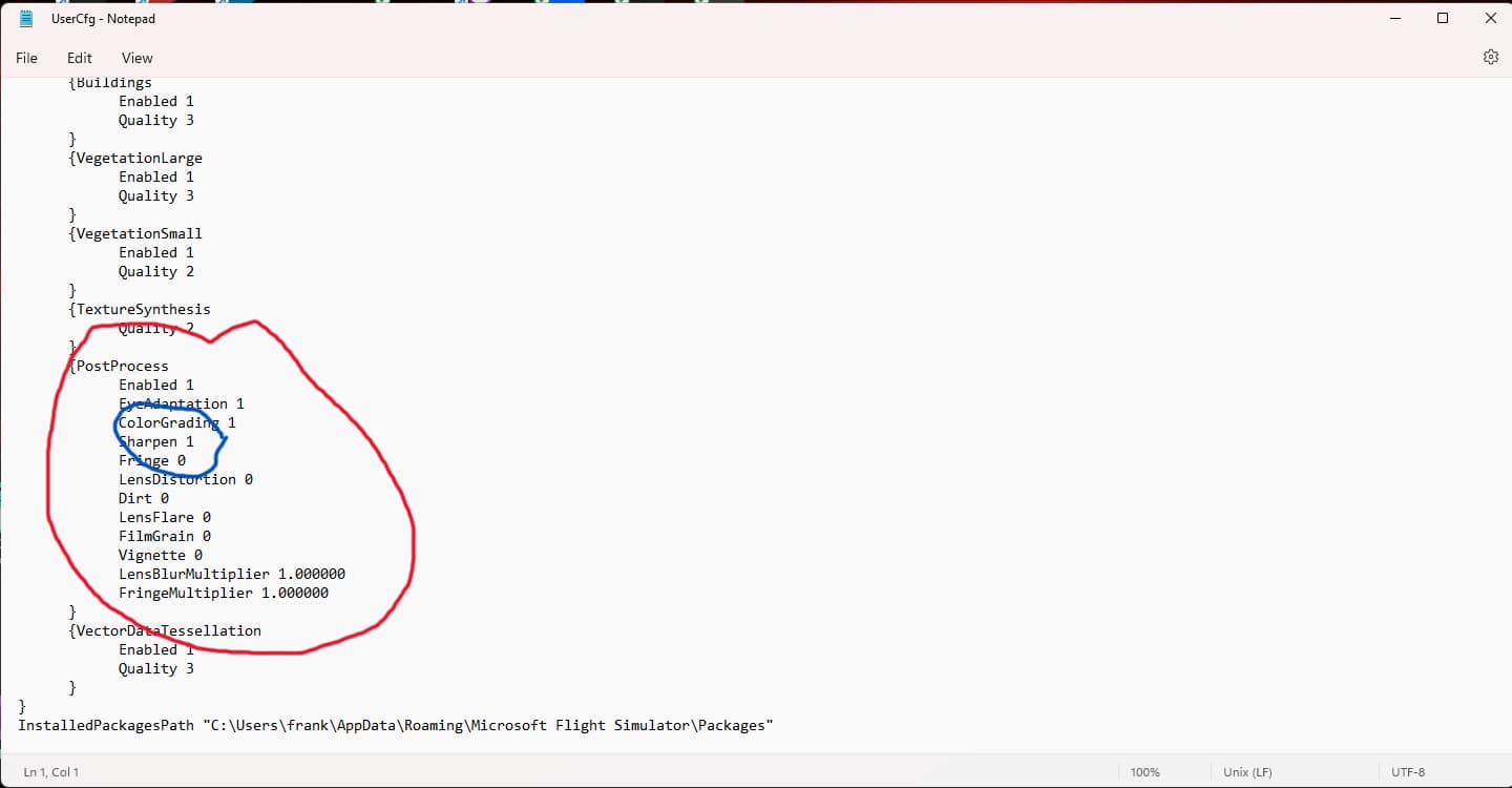

Also, changed config file back to default. I’m really setting myself up for Helicopter flying for next month, so on all my tests with fixed wings I am about 2000 ft.

XR:
fsr (on)
scalling 100%
sharpening 100%
manuel resolution ca 3300x4500
pitool:
potato mode
ss1
refresh 75Hz
compulsive smooth 1/2
Results: 3300x4500, compulsive 38Hz (72Hz) over cities constant 38Hz

I made my settings, finally I enjoy it. This game still has some issues (I raised several tickets, no responds yet), but at least I have very sharp and detailed picture in front of me - a strong foveated is applied with a huge supersampling in center, also shape of foveated is suitable for Pimax normal FOV. If you use it, try not to look around with eyes, but with turning your head.
I have usually more then 30FPS, and with Pimax 8kx in 90Hz mode it looks nice, and I do not have flashing from screens as in 60Hz mode. As I understand HMD shows picture 90 times in second, even if picture changes every 2-3 frames - that is really good enough for this game.
For my settings you need PimaxXR, and OpenXR Toolkit.
Pitool settings pp=off, normal fov, render quality 1, fixed foveated closed, hidden area mask on, no smart smoothing and no compulsive smooth here, native 90Hz screen mode, .
Game settings: 1.29 MB file on MEGA
OpenXR settings: 1.87 MB file on MEGA
I have nvidia 3090, cpu 8700k
