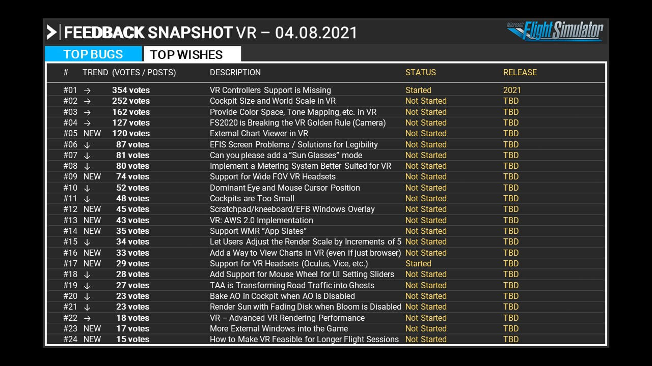

Everyone - While this issue isn’t fixed yet, through perseverance with speaking to the MSFS support staff via DM and the forum I believe I have finally made them aware of what this issue actually is (ie. proper support for cantered display headsets) and also the fact it has been voted on and discussed numerous times which Asobo were initially not aware of.
Big thanks to others as well that made the original posts regarding the issue as all I have done is provide some clarity and focus for the Asobo team to become aware of those threads and the actual issue at hand (ie not incompatibility with OpenXR).
For anyone who has not voted and would like to do so, here is the link once again: Support for Wide FOV VR headsets (removing Frustum Culling issue)- - Wishlist - Microsoft Flight Simulator Forums
Evidence it has now officially been recognised, See #09. It isn’t yet being worked on but at least the proper recognition is a big step forward:
