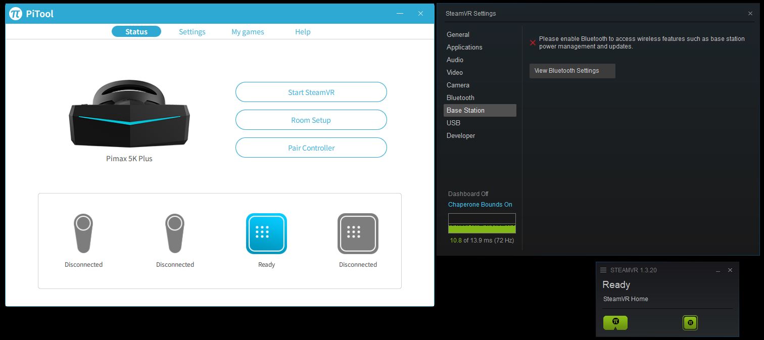

I’ve been using my Pimax 5k+ with a Lighthouse 1.0 but our studio now has access to a couple Lighthouse 2.0 base stations.
I find that if I set one up the Pimax will detect it and they work, but through SteamVR there is no way to get into the settings for the base station to adjust the channel or other options.
I find that if I connect up the link box from an OG HTC Vive, that does make bluetooth available on the PC, but that headset does not detect the Lighthouse 2.0. When I go back to the Pimax, then the bluetooth is no longer available.
Is it possible to use Lighthouse 2.0 base stations with the Pimax and get into the settings in SteamVR?

The Lighthouse 2.0 Base Stations have channels. 0-15 I believe. Each one needs to be on a different channel. You can switch them by pressing a paper clip through a little hole on the back, but there is no way to tell what channel one is using outside SteamVR. With a Vive Pro, you can check through SteamVR. There should also be settings as far as power control.
I guess this is something which the LH transmits by the laser, so it would be up to the headset (or the controller) to report the channel to the SteamVR. Could be that Pimax has just not implemented it.
The Power Management via BT seems to work only when the Vive headset is attached as it has the BT LE adapter inside.

For some reason Valve decided to remove the ability to control the lighthouses in SteamVR using non-Vive Bluetooth connections. Some workarounds were posted here:
https://community.openmr.ai/t/how-to-power-off-basestations-remotely/15205?u=davebobman
