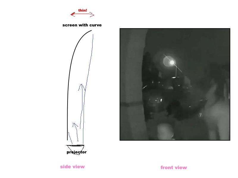

I remember before flatscreens were available that some people had camera doorbells with a flat monitor in the house. It was actually a sort of projector onto a curved surface which produced a ‘flat’ screen.
I will try to illustrate it because I couldn’t find a google image for it.
So the projector has a certain squished version of the final image that corelates to the curve in the projector screen. I imagine something like that could be used to wrap the image around someones head and then addition lenses would be used to get it all in focus like we do now
Probably not unlike the new near wall laser projetors
