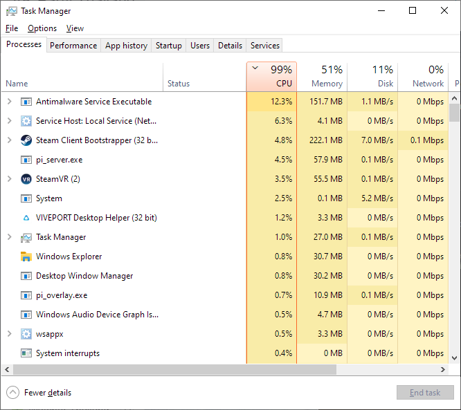

I don’t know what happend, but it look Pitool become worse (or steamvr).
It get a lot of jitter and you will see look like watching mirror in mirror (Infinity of image from bigger to smaller).
I ever played gunheart and now it can’t be played although I don’t set sampling.
Can’t open the Arizona Sunshine. May I have to test other headset to compare what is wrong.
edit : Okay, I know the cause. It look my cpu run to 100% and still don’t know what happened. Have to solve this first.
It look Pitool use much cpu too.
