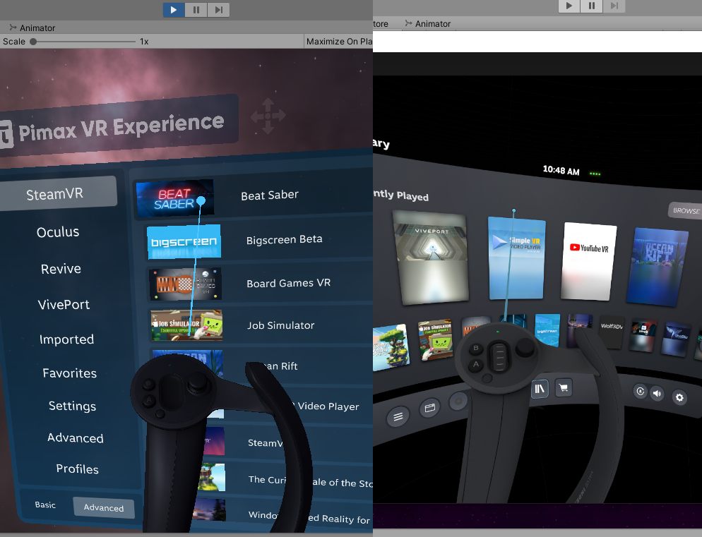

It seems to me like the pointer (only tried with the right controller actually) when using an Index controller points slightly (a few degrees maybe?) to the right?

I have tried to align the pointer according to how StamVR does it, but let me double check this and correct if needed :slight_smile:

Pretty sure I noticed it because it was different than in the SteamVR dashboard when I excited SteamVR and was returned to PE… :slightly_smiling_face:
If it is indeed the same as in SteamVR I just never noticed as I never (willingly) beta tested that (on purpose)… :upside_down_face:
Indeed. Let me check that later today, its easily fixable :slight_smile:
You were right @DrWilken, the laser was off around 4 degrees ro right. II think its better now, will add it to next release! Thanks a lot for pointing this out :slight_smile:

The hand position with hand-tracking is now also fixed. will be added in next beta.
