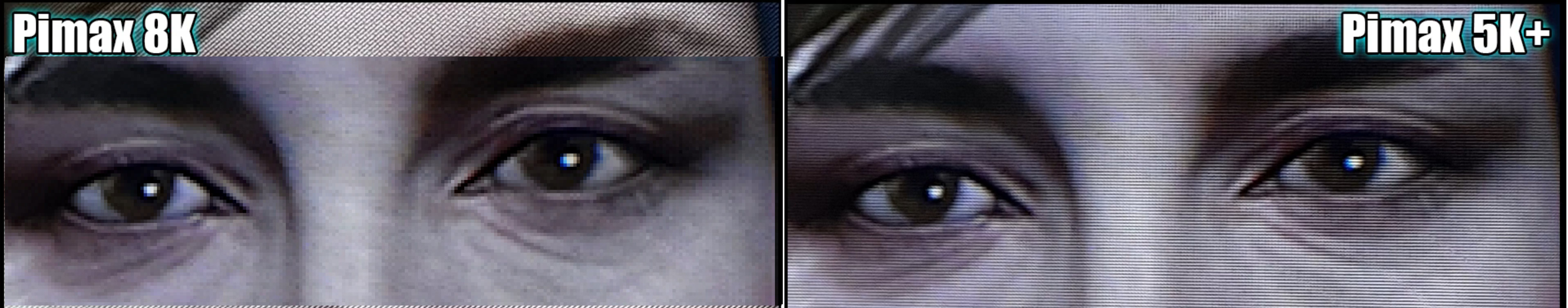

Here’s an example of what I mean. The first image is captured from SweViver’s video…

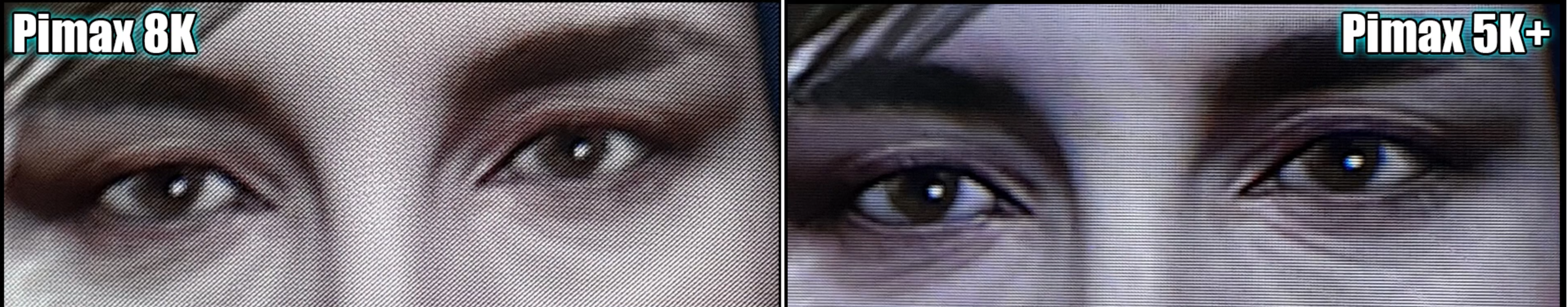

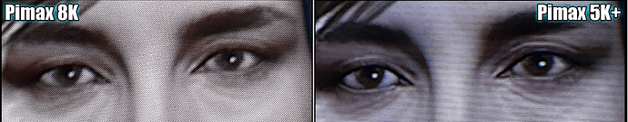

Then I took the 5K+ image, reduced down to 25%, sharpened it a lot, and then stretched it back to 100%. Notice how the details were preserved?
More info…
https://diffractionlimited.com/help/maximdl/High-Pass_Filtering.htm
Look for “Unsharp Mask Sharpening” below…
http://developer.download.nvidia.com/shaderlibrary/webpages/hlsl_shaders.html
This discusses implementing a “blend” filter, but that is just a variation on the convolution matrix settings and can easily be adapted into a “sharpen” filter…
