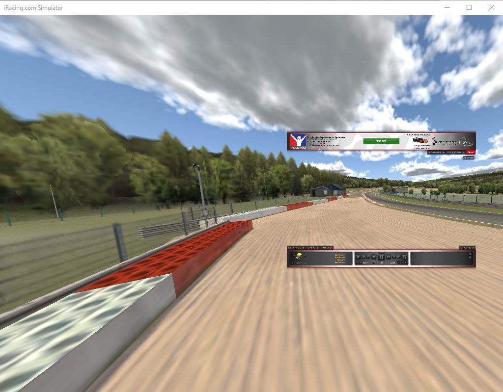

Iracing graphics are low res and nothing I do fixes it... HELP!
I’m having problems getting iracing graphics from looking low res. I’ve tried everything I could think of and searched the forum but can’t find a solution. I’ve tried different pitools (including the newest beta), different setting in both pitool settings and steam vr, as well as different settings in iracing.
Using the same iracing settings in Oculus I get clean crisp graphics, but switch to Pimax 5K and it looks like this…
Any help to resolve this issue would be much appreciated.

Here’s My settings. No issues at all
I turned off Parallel Projections. Turned on SPS in iRacing. PiTool Normal FOV, 1.0, SteamVR SS at 150% (Per Application), SteamVR 100% Global SS,
and Here’s my renderedDX11 file. Copy and paste it into your file, and make a backup of your current one, just in case.

Thanks for the feedback. I’ll try out your settings and will report back.
Cheers!
Good lord are you sure you didnt leave anything out. :grin:
YEP left out one thing… where do I find the renderedDX11 file? Looked in the normal places but it’s eluding me.
Ahhhh found it… it’s “rendererDX11” and not “renderedDX11”
I’ll now give it a go…
Look in Documents/iRacing its called rendererDX11.dll
If you use PP Off, the steamVR Resolution changes by around 55% (I went from 100% SS to 156% to keep the same resolution I had).
So if you’ve been using PP On, make sure you check the SS Resolution target in the SteamVR Settings.
Interesting…
Using iRacing website to launch I’d end up with low res graphics every time no matter what the settings… then I thought, add iRacing to Steam and see what happens.
Well Steam only found the iRacing Beta UI so I went ahead and added it to Steam.
Now when I launch and go through the Beta UI the graphics are perfect!
I don’t know if the Beta UI would have worked without going through Steam, but I’m not going to delete it from Steam to find out… don’t want to mess with what’s working.
I hope others who might run into the same issue as I did finds this helpful.
