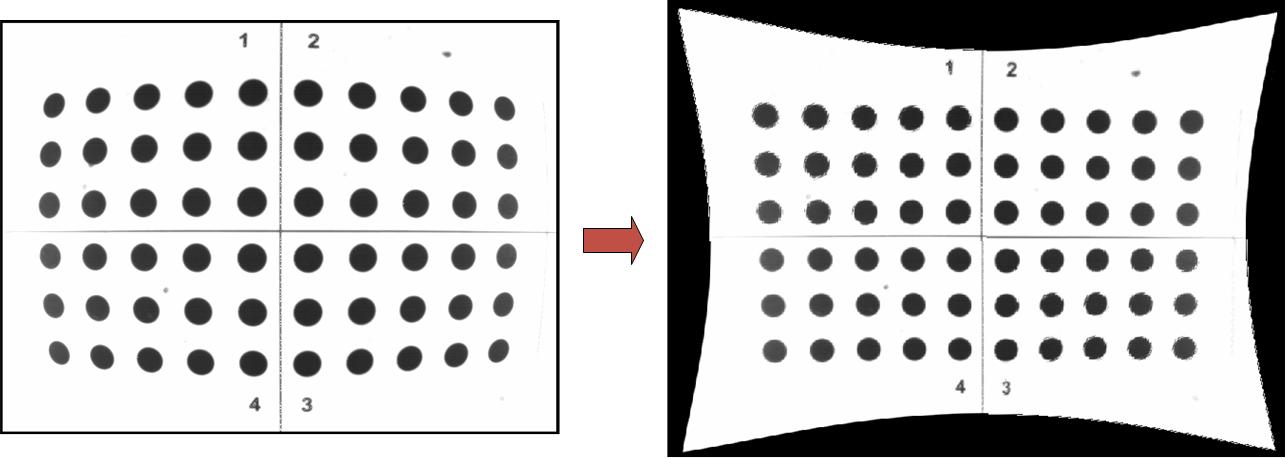

@Sjef That effect is called “Polynomial_Barrel_Distortion”, in some injectors you can play it around with config parameters, maybe we can ask to Pimax add this feature in Piplay… some example below
Well distortion happens in VR all the time. If you look through a lens at a paper, you’ll see very very heavy distortion, that’s what lenses do. So to solve that problem, VR headsets pre distort the image, so that if you’d look at it through the lens, you’d see the original image again. However obviously that doesn’t work very well in the pimax hmd’s.
