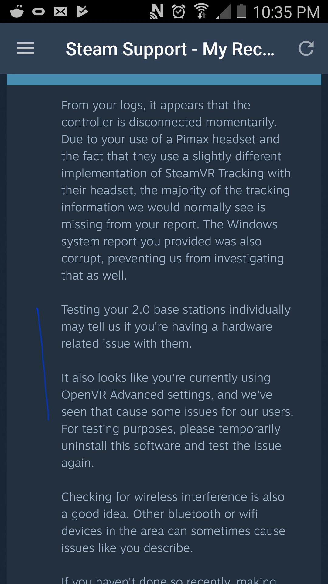

Having issues with my knuckles and 2.0 lighthouses,one controller will randomly dissapear or shoot of f the longer i play the worse and more regular it get,heres what steam support say
do you have v1 lighthouses too? i dont have any issues with them and index controllers
Y eah i tried my 1.0 lighthouses and thought id cracked it but after 90 mins exactly the same,have tried the knuckles on vive and all is great,steam are right its definetly a pimax software issue caused through pitool hijacking the steam vr tracking
