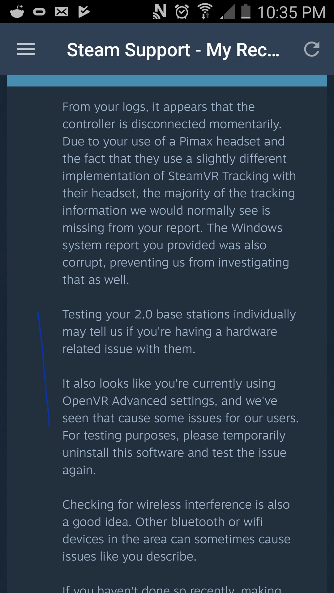

Steams reply to knuckles and pimax tracking issues,time to ditch the pimax fed up of all the troubleshooting its taking the fun outta vr for ma
Have you tried ditching openvr advanced settings as mentioned? And limiting Wireless interferences?
Would be interesting to compare logs with someone that has it working. There would likely be a different amount of tracking data headset wise due to difference in number of sensors & positions.
Mind you, they’re not saying Pimax tracking is crap, just that they’re not using the same log levels as the default implementation.
Btw, what log files did you send them where you can see the disconnects? Would be interesting for the rest of us to check.
It was the steam vr logs and the windows logs
