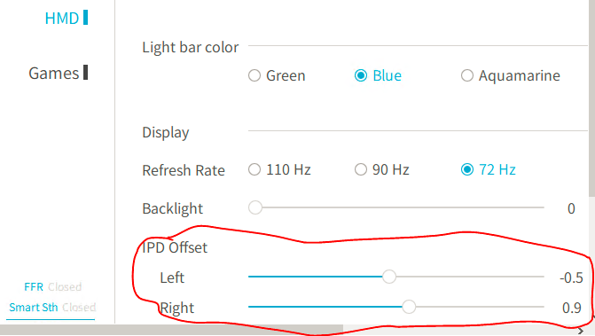

I had similar problems with my 8k+. I could only play for 1 hour at a time and it was very exhausting. With pitool version 1.0.2.86 you can adjust the ipd offset for each eye individually. after some time i found the optimal setting for me. Now i can play for several hours without problems
Download link - https://drive.google.com/file/d/1OL5kNU4CehXc1t6BNpRqsLTL9WoV7W3-/view?usp=sharing

hey, I have already been using the latest beta tool which does not only allow to set software ipd for both eyes separately but in addition also in increments of only 0.1 instead of 0.5. However none of that helped as I wrote in my initial post.
grafik
Edit: sorry Profundido didn’t read your post exactly
I had tryed thousands differnt setting. But know this are my perfect settings. btw. I use my 8k+ since March an since a few weeks it works as I wanted
This probably helps you because you have asymmetrical ipd, some of us are almost perfectly symmetrical so this tip doesn’t help
