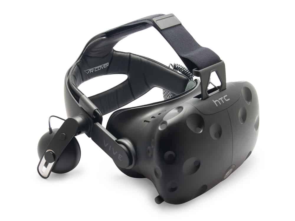

I found the DAS was a major improvement, so just want to make sure you know the knob at the back of the DAS rotates to adjust the length of the side straps, the top support is velcro just like the standard straps.
So rotate the knob to loosen the sides, put the headset on and hold it where you find it clearest, use your other hand to make sure the DAS sits on the LOWER back of your skull, tighten the knob, then pull the top velcro tight and stick it down to support the weight of the headset.
