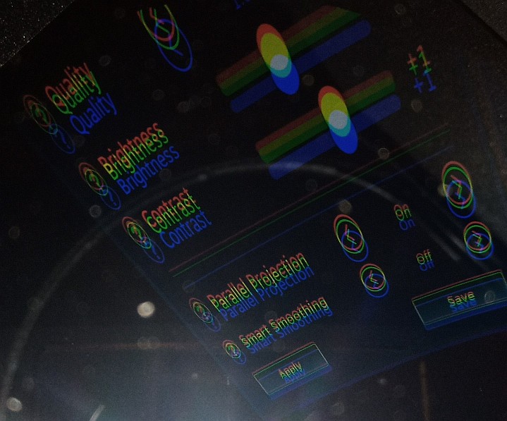

Here is what the 8kX looks like without lenses – that is quite a bit of chromatic abberration compensation, and it works remarkably well. :slight_smile:
So they compensate for CA already? Through software? Holy crap! Thats REALLY bad. Incredible they can compensate at all!?
Dumb followup question - why cant they correct for distortions…or do they? And if they do why is there so much smearing in the periphery of the FOV -cant they just fix that? Or is that something beyond distortion…
