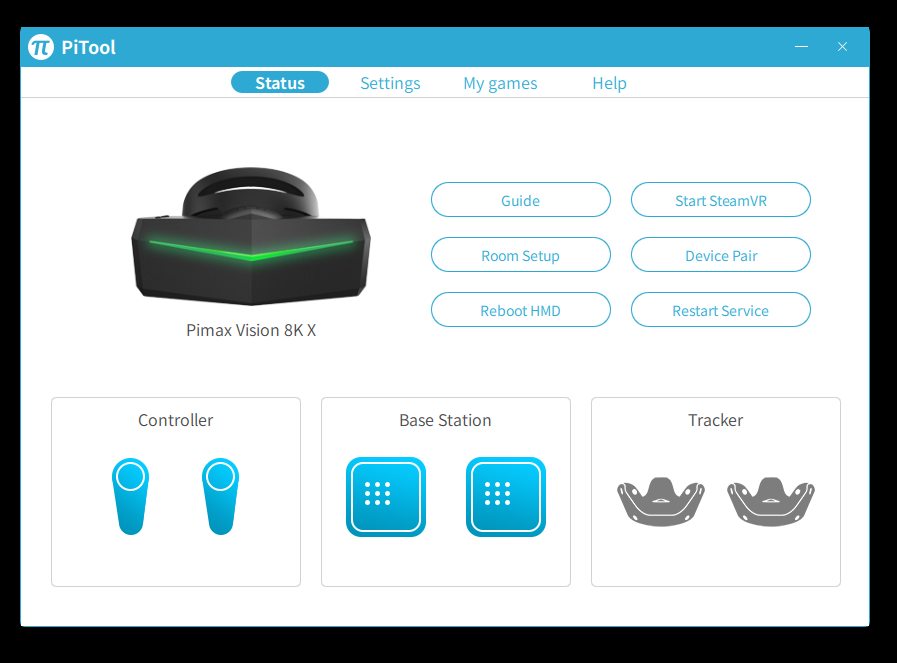

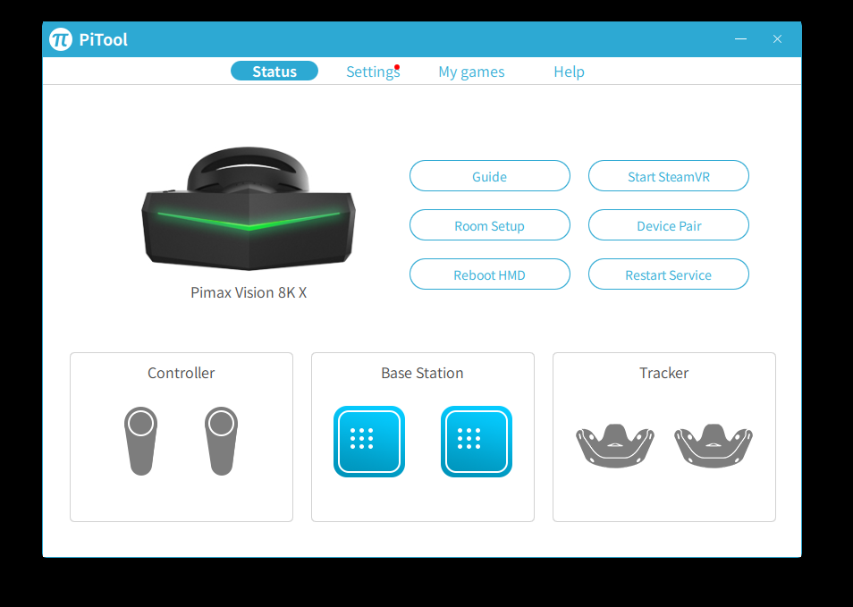

I got a sword controller today.
I charged them and launched PiTool, but the controller is not recognized.
I checked the pairing item. There is no description of the sword controller there.
I checked the FAQ. There is no description of the pairing method.
So how do I set it up?
Pair as Index controllers.
By updating to PiTool version V275 and firmware V299, the Device Pair page was displayed and the controller was recognized.
By the way, when I pull out the USB cable from the controller, the power turns off. Do I need to use it by wire?
No need to use cable. Just make sure that They are fully charged. Our batteries arrived charged so there was no need.
After you remove the cable then just restart the controllers.
A stupid question, you did insert the batteries?
The battery was inserted in reverse.
