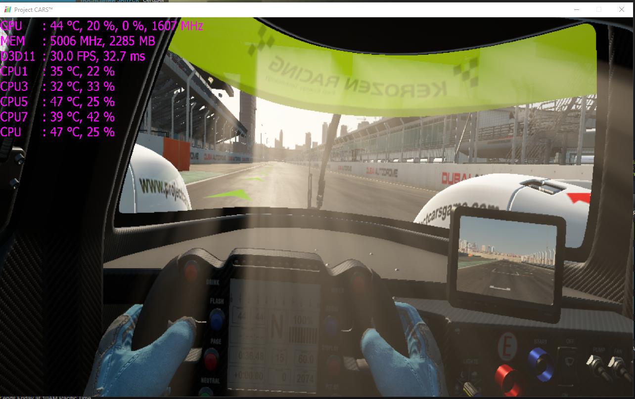

Sooo, i was trying to find out best settings for different applications while trying different supersampling ranges through steamvr and noticed that my fps in project cars and couple other games is locked on 30 fps.
The question is if the fps shown on my monitor is exactly same as in hmd and how to find if the game performs good or not?
Example:
p.s. i run 1080gtx, so there should be no lack of ressources to get more then 30 fps. Screenshot from the top is made with lowest quality (lowest ingame, fullhd pimax / not 2k, no supersampling, no aa; enabling all this things keeps same 30 fps)

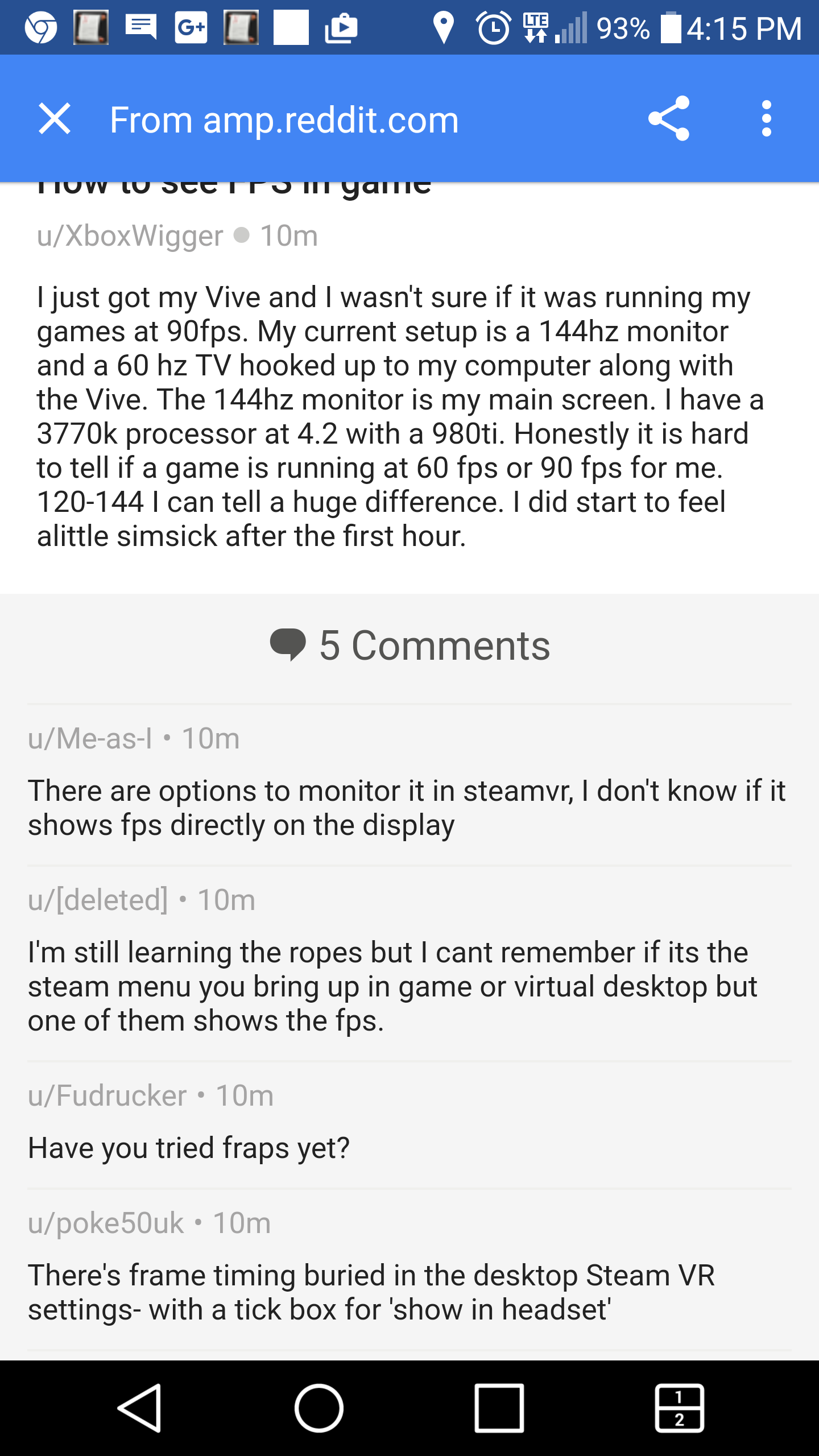

Sj have you checked in steamvr desktop settings? That post i found said there is a buried setting “show in headset” not home so haven’t been able to check.
Ah yes, it’s in the SteamVR settings under Performance and then the button Display Frame Timing, which will open a window and then you can select ‘show in Headset’. But I’m not sure what I’m looking at exactly, I don’t think it’s FPS ? And it just seems to mirror the window to the headset.
