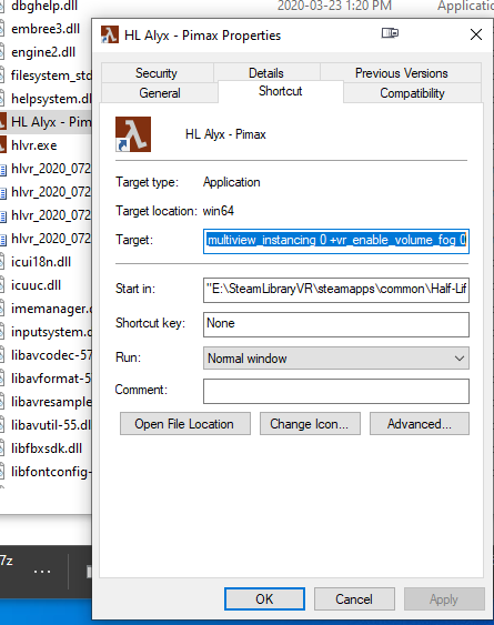

The solution is to disable Multiview instancing by adding this into the Half Life Alyx launch options:
+vr_multiview_instancing 0
So the final line will look like this:
-console -vconsole +sc_no_cull 1 +vr_multiview_instancing 0 +vr_enable_volume_fog 0
Now I can enjoy a full field of view without any rendering issues and without parallel projection on the StarVR One! This also works for Pimax headsets.

Do you know if this will work instead of adding it inside of steam. as /i have multiple hmds and only want this enabled with pimax
@SweViver i don’t remember but in the new Pimax Exp we have the ability to add custom arguments for launch in pitool?
