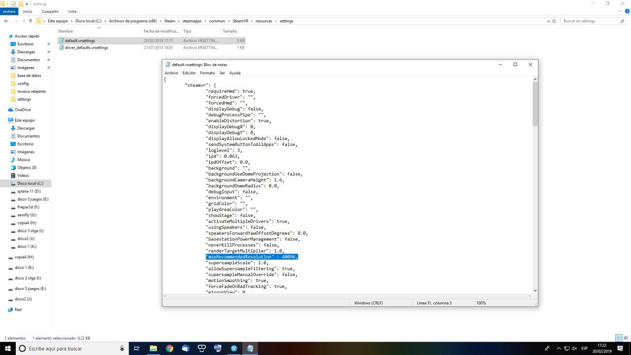

A few days ago talking to a friend of a group of Telegram in Spain that we have for the sponsors of pimax 8k, he told us that he saw a default.vrsettings file in the configuration of SteamVR with a parameter maxRecommendedResolution: 4096, he modified that value and now if it admits an SS greater than a resolution of 4096.

You mean he saw a value of 4096 and changed it to 40096.
No, by default the value is 4096 , what you did was put a value greater than 4096 , for example 40096.
The default value is 4096. I set it to 8096. Bingo! application resolution elite dangerous at 6100x3000: super sharp @ large FOV!! In addition I set rendertarget multiplier to 2:0.

The default is 4096. Your friend probably said to add the 0 because there’s no way anyone would go that high, so there’s no need to go back in to edit it.

Exactly, that’s right , the default value is 4096

I set it to “maxRecommendedResolution”: 6144,
:man_shrugging:
The default vrsettings file seems to be written to every time steamVR is launched when pitool is running. This does not happen steamVR is launched on its own (without pi tool running)
Hmmm… May need to try making it read only & see if it works.
