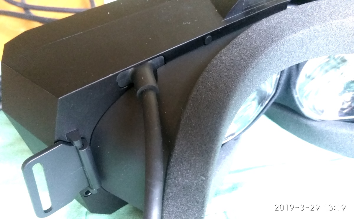

How do you replace the display port cable?
I cannot see any pictures of someone having done this. Where are the release points for the plastic shroud as it is partially covering the cable end.

just found the answer for anyone else looking Sweviver YouTube video @5 mins 55 secs
Hi…you dont need to remove the shroud like sweviver has done. Just press one finger on the shroud by the dp cable, grab the cable with the other hand and slightly wiggle it while applying a steady pull and it will pop out in seconds. Hope this helps
Thanks for advice Jason. Given the feedback from people on fragile casings I ended up doing that, it just seemed too hard to get out.
