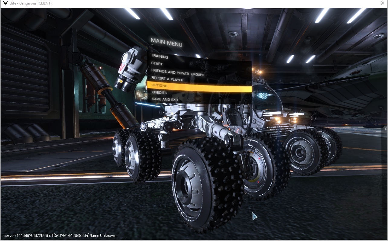

Thanks for the reply Luke, What drivers do you have installed and what firmware are you using on the Pimax, does yours connect as a HMD in your settings and menus for the game, if you could get a screenshot I would like to see it, how did you set up your Pimax software and any additional software.

Here are some screen shots. Hope their helpful.
I had to reduce the game monitor resolution setting and set it to windowed so that the screen grabs were small enough.
The display in the HMD is about the same as the frame grabs but with a wider field ov view and don’t appear curved like the PC monitor grabs.

I beleive he was looking for PiPlay version.
F/W in your Pic.
PiPlay 1.1.92? Current Stable PiPlay. All new versions have reduced Resolution. Tho think newest version while reduced might not have as much compressed look. Fer said would test more.
Yep. I was on the Beta .23 version, uninstalled it and changed to .92 version and yes its now what it should look like, thanks Luke and Heliosurge.
