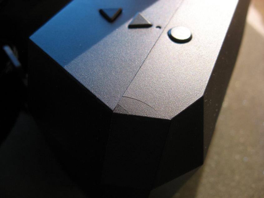

My first 5K+ started cracking a few weeks in and progressed over the first year. I RMA’d it before the year was up.
My replacement got a small corner chip (my fault from hitting it with a controller so won’t RMA) but hasn’t expanded in several months. Got a Pimax protective sleeve which aside protection also shows where the sensors reside with it’s cut outs.
My 5k+ has developed the cracks.
I’m pretty sure every single HMD without RE housing will crack at some point. I’ve seen some crazy ones, but my HMD is out of warranty, been cracked. Now developing one up the front of the hmd slightly, but it’s very thin.
Honestly I think the best move is to just buy the silicon sleeve and forget about it. I don’t think this is gonna get bad enough to cause light leakage for 99% of people

I have waited just before the warranty ends to RMA my KS 5K+ (many cracks, pictures in this thread).
Received the replacement a week ago, inspected at unboxing, no visible crack.
I have used it 2 times, mostly to check if all the problems I had with the 1st unit were solved.
Approx 3 hours of use in total, with great care (it rests over a large thick foam pad after using it).
Checked it today: both top front corners already cracked… (pictures below)
This is very disappointing. Changes may have been made on the manufacturing process but the result is there, replacement still cracking after only 7 days / 3 hours of use, with no shock, no sun exposure, 20-23°C ambiant temperature, no cleaning liquid…
So what now ? Will Pimax offer to replace it now the warranty is over but the replacement began to crack so quickly ? @PimaxUSA
The replacement is a 203 version according to S/N, manufactured on September 2019 (if the date is now written like that in S/N and not using week number like before).

The black housings crack. They will always crack, I wouldn’t expect anything otherwise at this point. Some claims have been made to the contrary, but evidence up to now strongly suggests that the issue has not (and will not) be fixed. I think that only the new RE/Vision series housings can truly address this… maybe. There are also concerns that the housing underneath the rubber coating may crack as well, and truly we’d never know it if this were the case.

When I see reports just above from people with 3 cracking replacements, on top of mine that also cracked right away with so little usetime, no way can I believe this would only be affecting some production batches, nor that the percentage of cracking units could be as low as claimed.
So idk what to do with my replacement now. It also has one dead pixel but the other issues from my first unit are gone (horizontal scanlines and faulty USB cable), excepting the cracks.
I have reported the cracks in the ticket I had used for the initial replacement request, I will see if a solution is proposed there (possibly a protective cover as for other people).
I don’t want to tape the casing, but maybe applying a very small amount of epoxy right now would prevent the cracks to expand more with a minimal visible impact. Especially if then covered/hidden with a protective cover (but some reports about dead panels will make me think twice before using such cover, as they may have gone dead due to overheating because of that cover).
