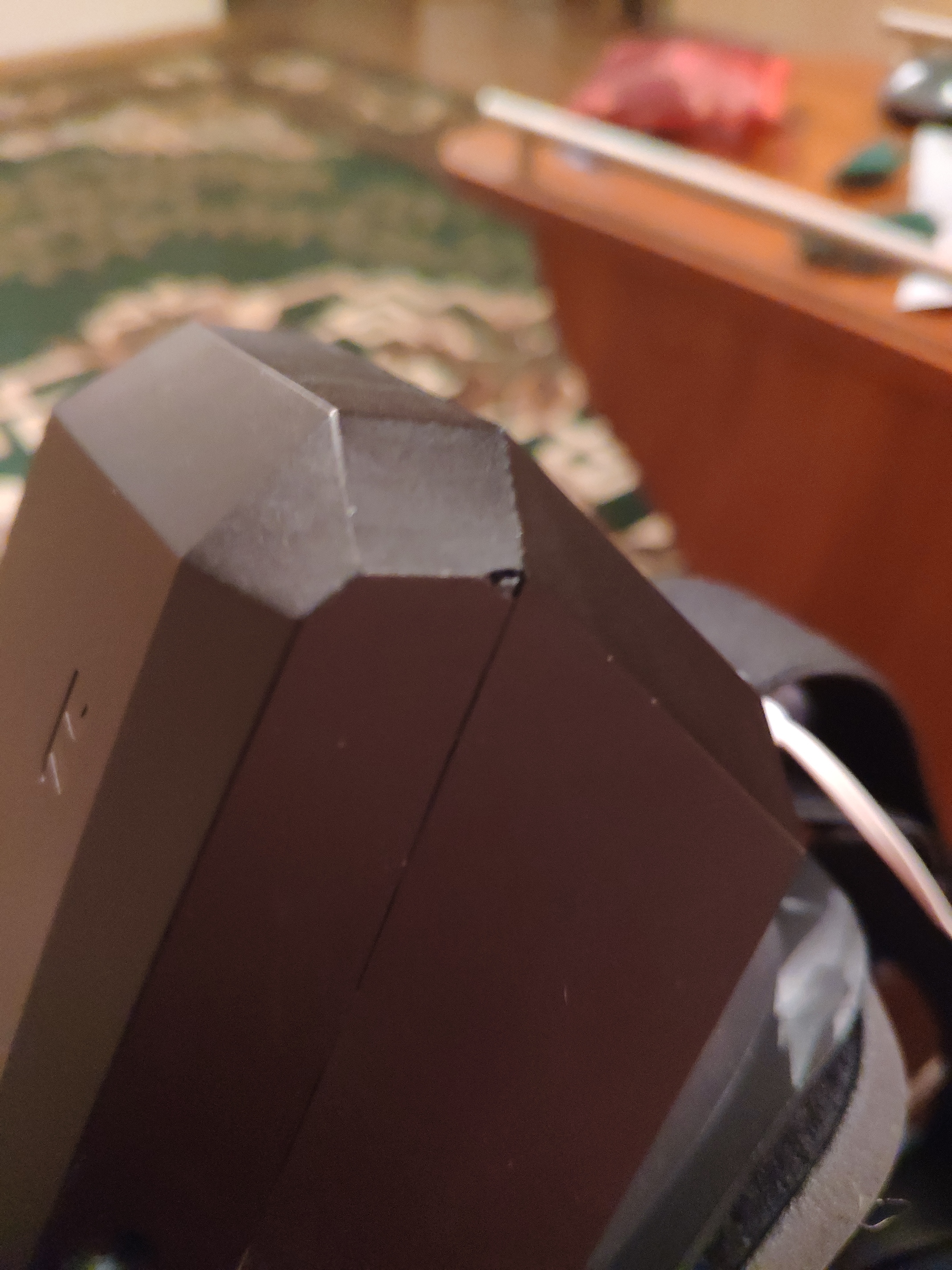

I’ve had my 8K for 2 weeks. It looks like there might be a very tiny crack starting in 1 corner. I’ve been treating mine very gently.
In case someone wants to repair this later, once it’s out-of-warranty, what’s an appropriate option, epoxy perhaps?

I got my headset (5k+) at the start of the month, backer 50xx. All was good until a few days ago when I noticed tiny fractures to the corners of the casing. Do I have to send it in? I live in Norway so that would take a long time:(
Heard a guy got offered 100usd voucher to accept the faulty casing. Any news on that with regards to furter problems and warranty etc?

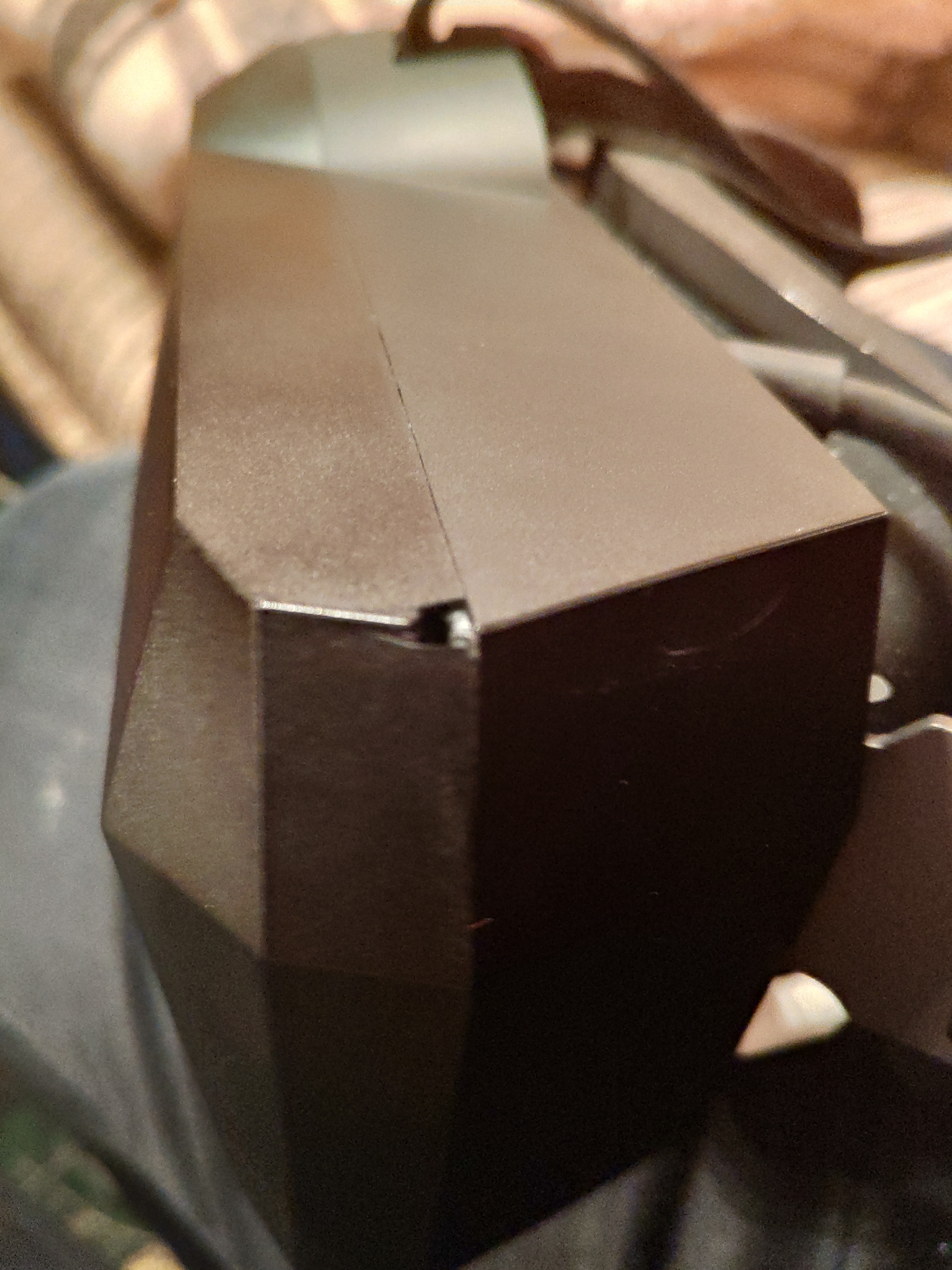

Guys looks like I joined your club as well. Have 1 big, 2 small cracks and holes at 3 corners. It has been only 2 weeks, and I was only checking Pimax with 3dof like simulation games. Never dropped, as reported by others I took Pimax everytime I used it with gentle. So what do we do?
IMG_20190317_231045|374x500
