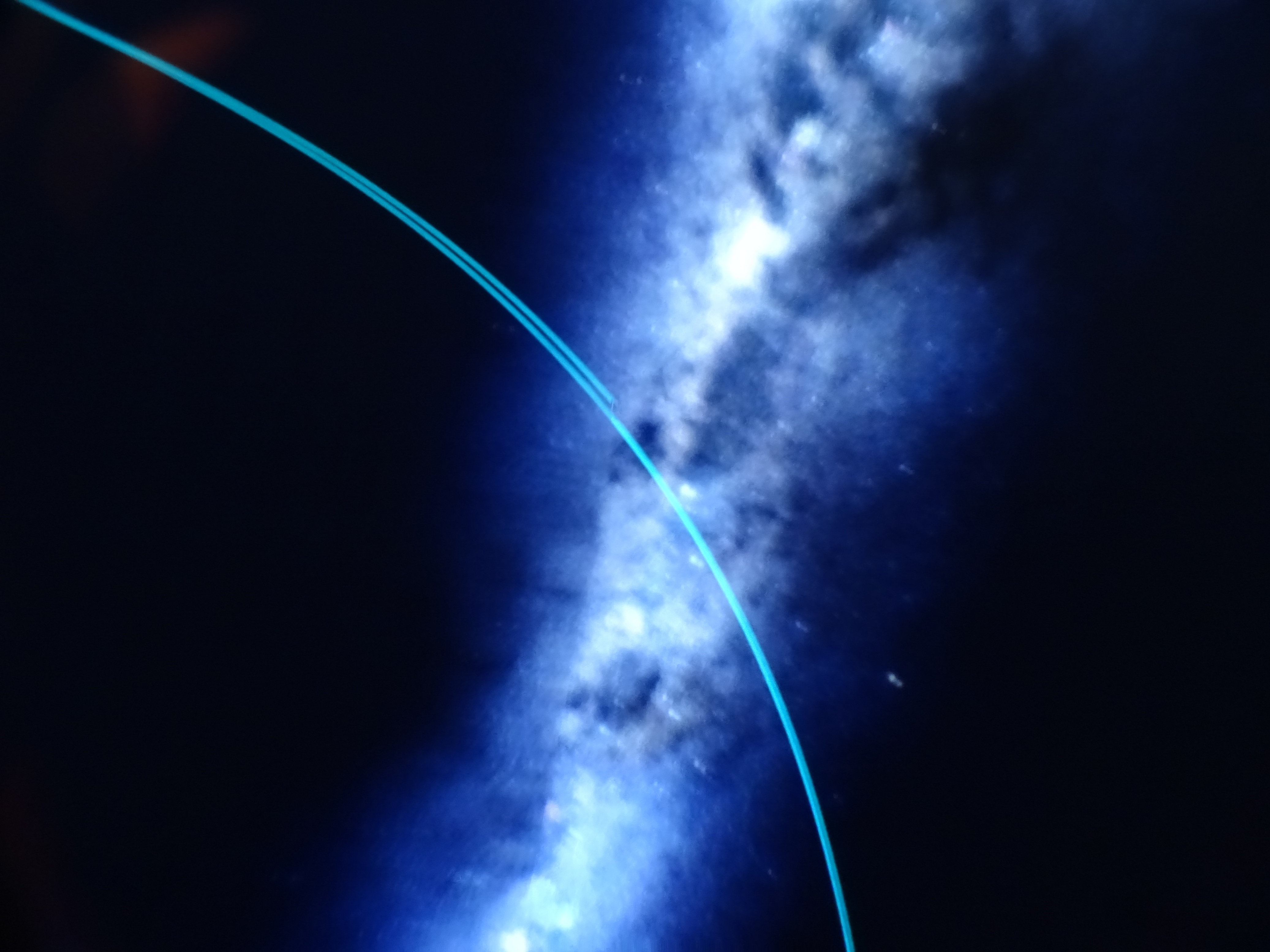

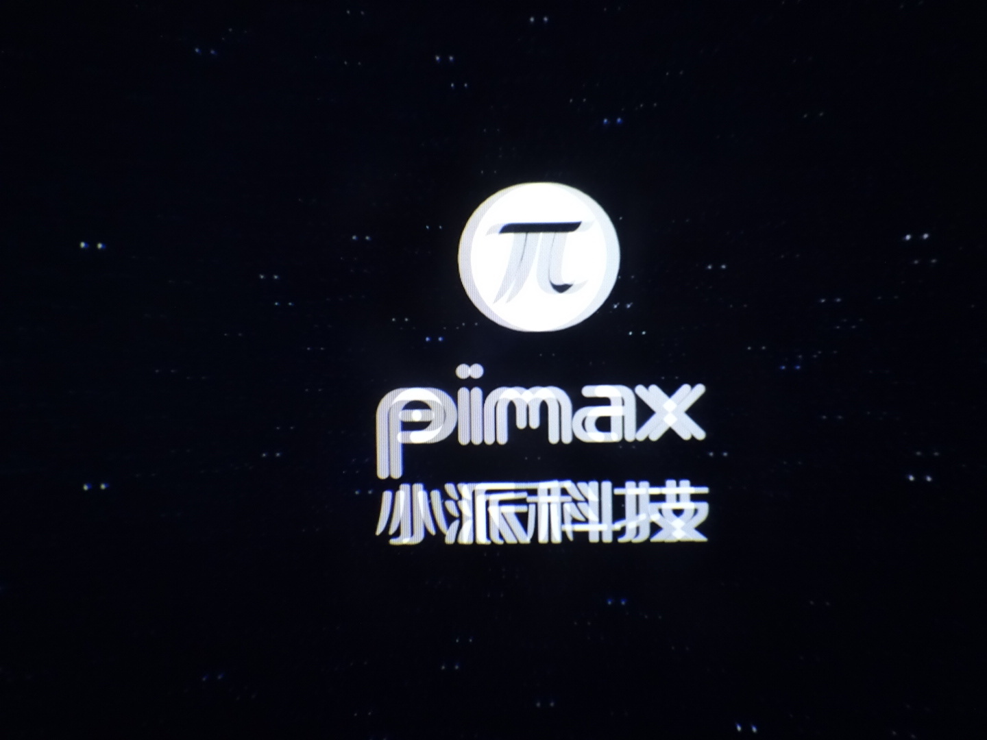

Tell me please how to solve the problem, the picture on the left and partially on the right eye bifurcates. I have an engineering education, I can perform repairs on site.
Hi, how did you capture above photos? Have you adjusted IPD(Pupil Distance) value in setting of Piplay?
He fingered the sensor and photographed the camera, IPD set different, there is a small change in the bifurcation
Hi, could I ask what’s your eyesight situation? And what’s version of Piplay & Firmware you used at present?
I have normal vision, I do not wear glasses. Piplay 1.2.57 Firmware 1.0.0.248
It’s a rare issue. Are you using multi-monitors? Could we use teamviewer at present?
Also please take a photo of playing games or videos, thanks.
I do not use multi-monitors. Teamviewer I can connect. It seems like one of the lenses has flown. Several photos for the right eye.

This is the EXACT issue i had a few days ago… posted on this thread. http://community.openmr.ai/t/just-rolled-back-to-1-1-92-and-now-both-lenses-are-showing-as-offset/1909/12
this happened to me when i tried installing 1.1.92 after already trying out the latest piplay version… as soon as i installed 1.1.92 i got the same issues on my headset. no fix was working, BUT it only happened when i was in PIMAX (direct mode) so made me realise that it was either pimax driver or steamvr causing it…
for me to fix it i went back to the latest piplay version and then it resolved itself - you need to unplug and replug in the USB and HDMI after a reboot once new drivers went in.
still dont know what caused it but removing steamvr setting had no effect.
hope this helps?
Eno
I’ve tried several versions of piplay, there is no difference, and I do not have 2 images bifurcated, but 1 + 1/2

Unfortunately, the installation of the new version did not help, the defect remained :frowning:
