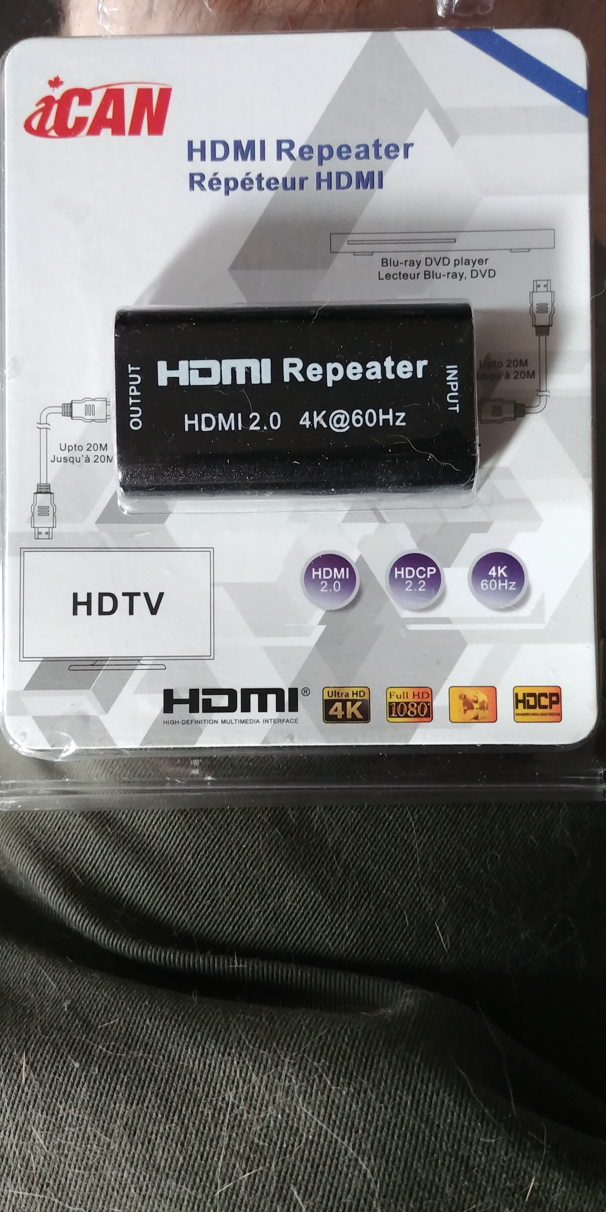

Hdmi i would try something like this i bought for $16 Canadian at Canada computers (haven’t tested yet.
Keep in mind the headset’s input is 1440p or in low spec mode 1080p.
fair enough but while a repeater would help with extending the cable it wouldn’t help the fact the current one is definitely dodgy so there wouldn’t be much point in going through a repeater when id be replacing the complete cable anyway.

The repeater idea is just to make it easier for length.
