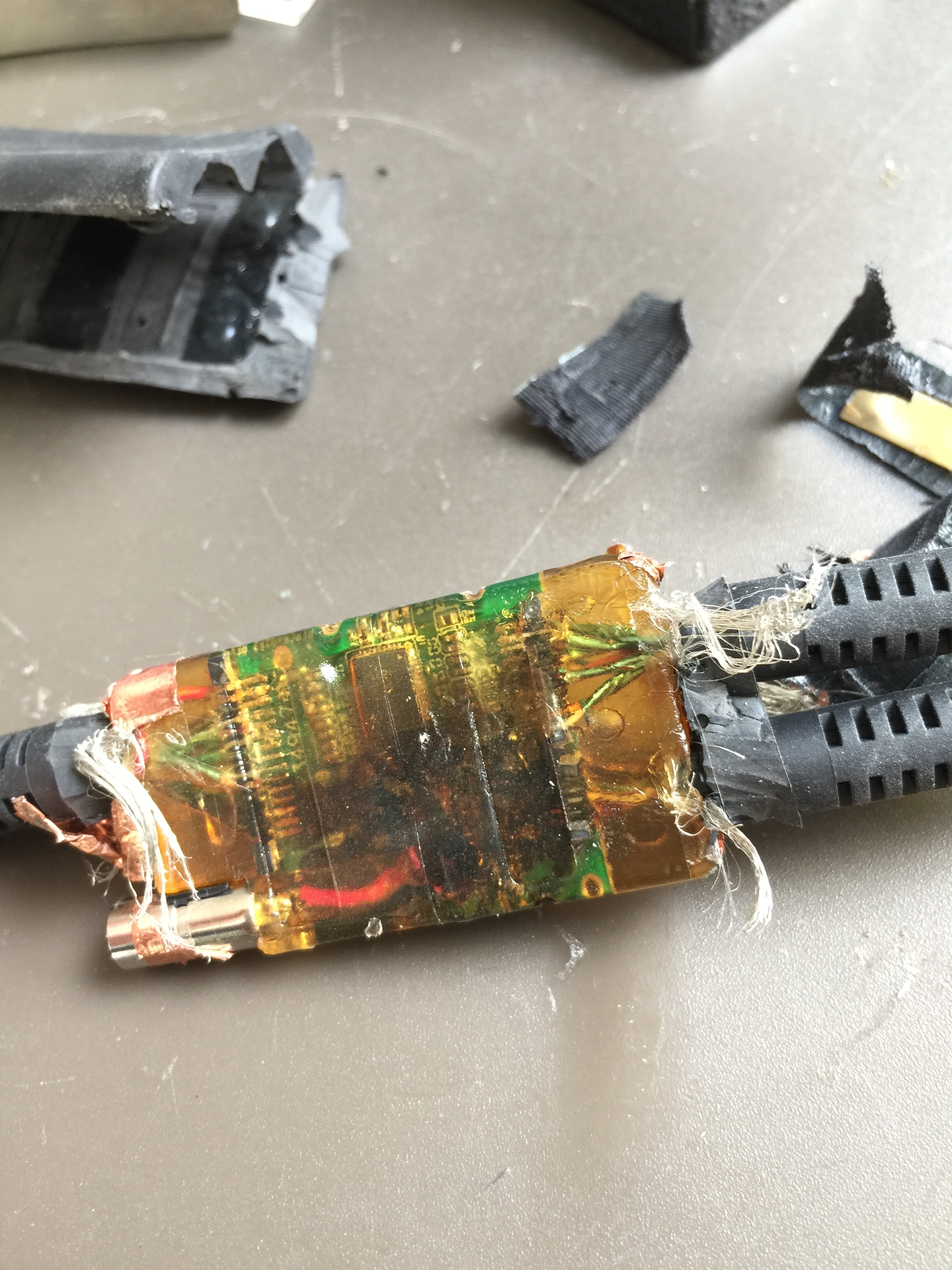

So I cut open my defective cable and this is the result. Totally fried inside near the 12V input, so that explains why my headset wasn’t getting power. Everything is encased in epoxy, wrapped in copper foil, then wrapped in a rubber casing, so it is impossible to repair.
So that’s the point where the culprit is located.
I always thought the cable issues were due to twisting and breaking of the cabelage, but instead it was a problem in there. Quite interesting.

Looks like it burnt up in there and caused some issues.
Will definitely take care of this matter.
