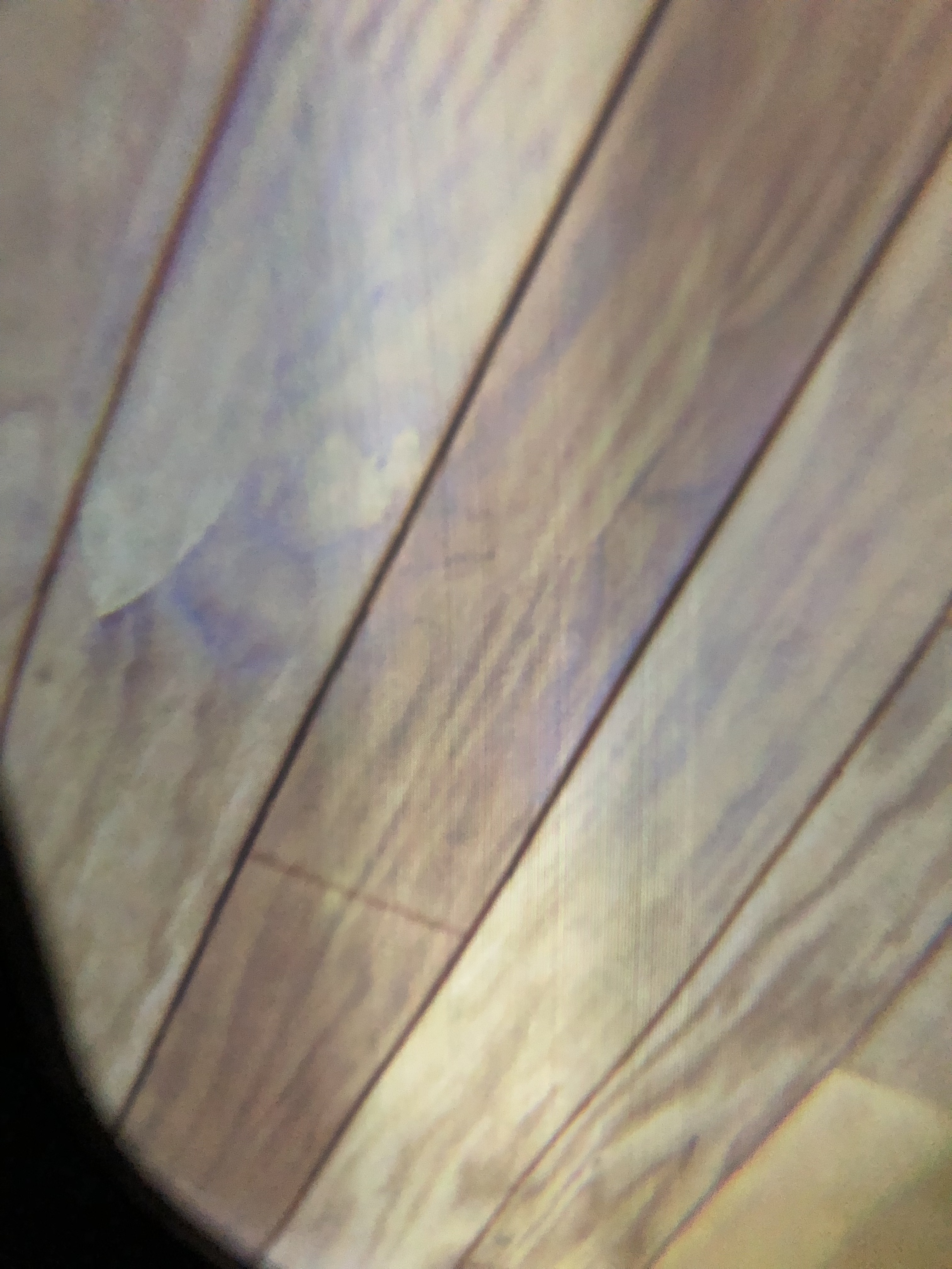

My pimax 8k is display error, Please look at the image, A horizontal line is in the center of the screen
Please tell me how to improve it

But there was a problem with the screen

I have a problem with my display

will still see a horizontal pattern on the display
