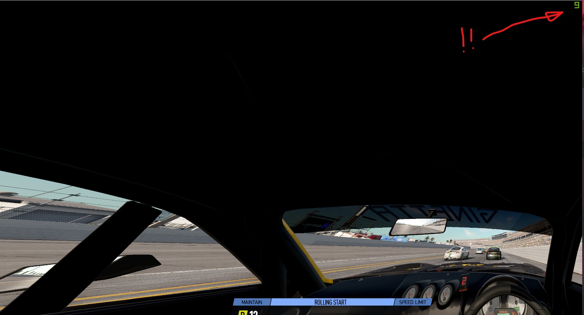

Help! 10 FPS in project cars 2 on lowest settings! - 2080ti 8kx
Hi, something changed recently. PC2 was running perfectly on medium settings at 75 FPS. Now down to 10 FPS on lowest settings!
Anybody know what happened?

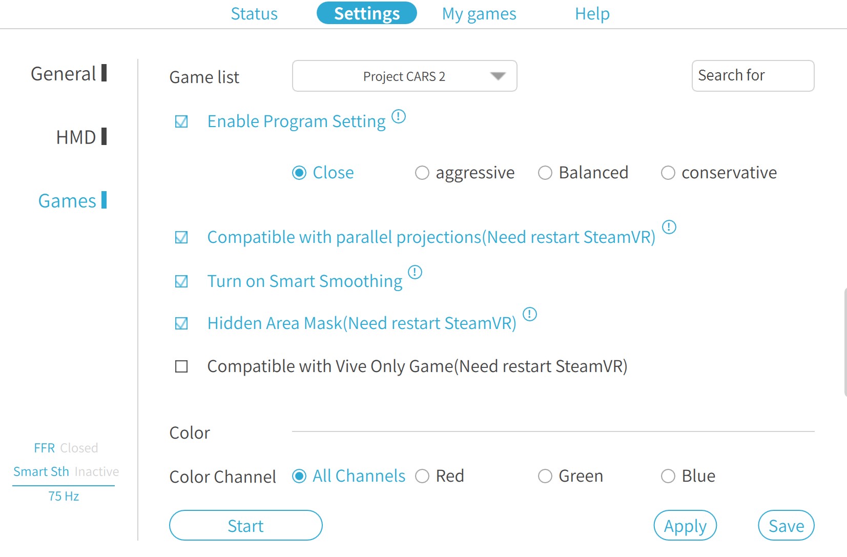

Can you share the rest if your system specs please?
Also if you could post your Pitool settings with steam and PJ cars settings may help.
Thanks!

Your problem is right in front of you. SteamVR SS at 100% is too high.
When you turn on PP the resolution increases like 2x or so. You need to try SteamVR SS 50% or so.
I recommend first setting pitool render quality to 1.0 or 1.25 or even 1.5, and than afterwards, setting steam resolution multiplier to some vaue so you get resolution per eye like shown like yyyy x 3330 (I always target this second number to be about 3300) Depending on game this can be at multiplier value of 20-30%. Even with my 1080ti I get acceptable frame rates with very good/sharp image.

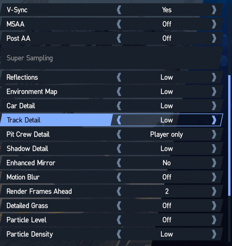

In-game supersampling under the VR settings?

Supersampling in game is set to 1.

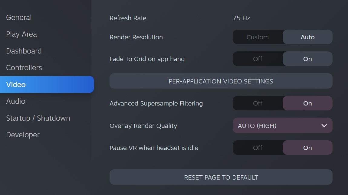

Set steam vr resolution not to automatic. Always to manual lets say 50% (if you use pimax 1.5 quality setting). Then as vorinami said, keep an eye on your vertical pixel settings. 3300v is a little optimistic for pc2 even with an 2080ti. If you have an 5k+ or 8k/+ your native vertical resolution rendered is 1440p and for the lens correction add another 15-20% and add some supersampling and you are fine with around 2000v. Anything more is hardly an visual improvement but taxing the gpu. If you have an 8kX then target 2700v (sweetspot is around 30% more than native). And reduce to normal or small in titles where parallel projection is needed. The amount of wasted pixel is enormous and the benefit of the extra fov (especial the blurry mess in large not worth it).

And set motion smoothing to off in steam vr. That does not work and is not needed with pimax headsets.
And advanced ss filter to off. Somwhere i read it is better to turn it off. Can’t remember why. But since then i have it always off.
Edit: to find the performance sweetspot for the vertical resolution for each game activate the performance overlay graph in the steamvr/developer menu and play around with different ingame quality and steamvr-ss resolution setting. Turn the ingame resolution setting to 720 or 768p. This is for the mirror view only and did give me some performance boost. I recall that the ingame menu resolution was reduced by it, so readability was worse.
