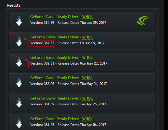

Hi, I suggest that you may select a lower version of graphics driver and manually intall it as below:
Tried a clean install of 382.33 & 382.53, still no luck
