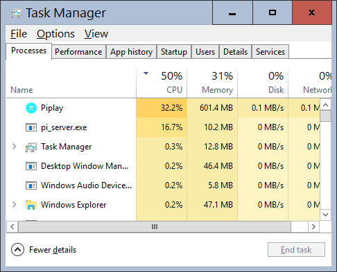

Lastly we have the issue with CPU use and the Pimax software. I’ve tracked down the biggest culprit to pi_server.exe. For me it sits around 20% use, even if SteamVR isn’t running. Also Piplay.exe likes to sit at around 30%, but I kill that app before launching steamvr and it works.

I do not have the CPU issue mentioned above. Pimax everyone is complaining about these issues. Are you guys working on fixes for this?
