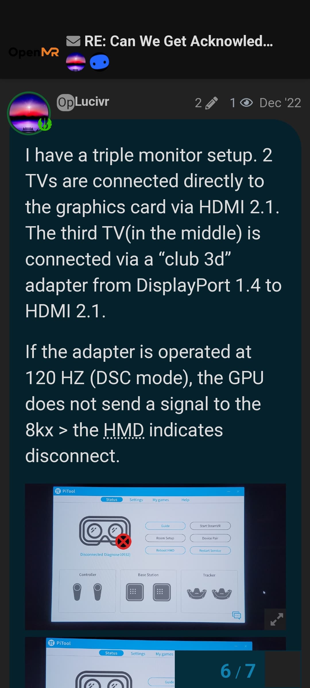

So, you’re having similar issue too…
Yea, the moment i turn off my OC mode on my monitor, and have it default to 144hz.
i can use my 8KX…and if its on…nope…Or if i leave 160hz mode on and unplug my 2nd monitor i can… its weird…
less weird. The graphics card is simply exhausted from a certain range (pixel/Hz).
you would figure with a 4090, it would be less of an issue with bandwidth.
specially seeing people with multimonitor and such…ect in the past
2080, 3080, 4090… the performance itself doesn’t affect it. DP 1.4 remains DP 1.4

I think this is a problem with Pimax not being able to run on two DSC-enabled display devices simultaneously. If you’re using a mode like 4K 144Hz 8-bit that doesn’t utilize the display’s DSC mode, it won’t be an issue. However, if you’re using a 4K 144Hz 10-bit mode or 4K160Hz 8-bit mode , it will enter the DSC mode. To work around this, you can either set the 8KX to a non-DSC mode at 75Hz or use the Windows key + P shortcut to disable DSC mode on the display when using the HMD.
