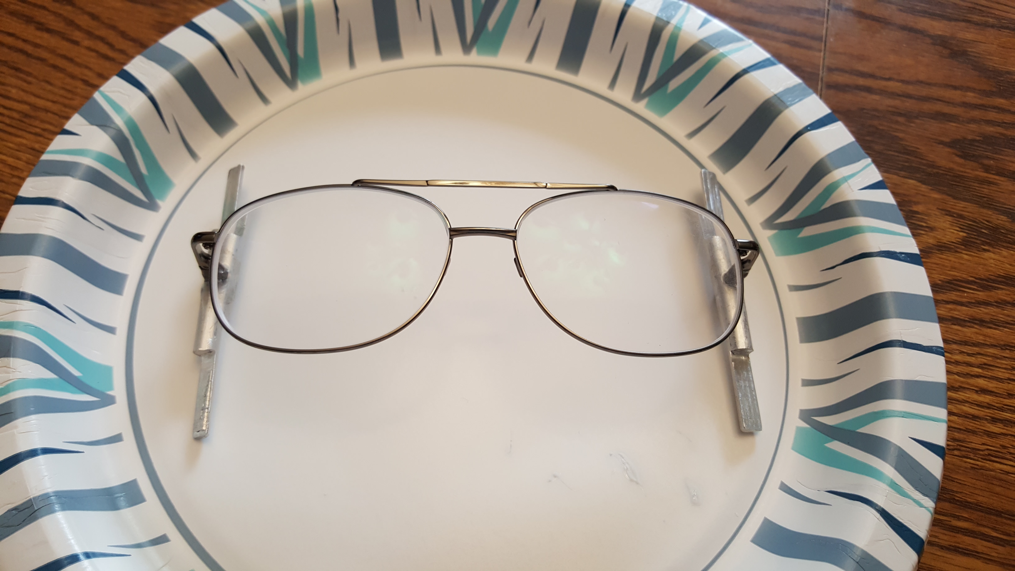

I got the frames in way earlier than expected. Unfortunately they are way too bulky to even fit in the headset I have another idea, though, and I can still use the glasses for a different project. Will report back if my new idea works.
This is the solution I came up with. I bought some cheap Zenni glasses and modified them using some super glue, flush cutters, a hacksaw, and a couple pieces I milled out off aluminum round stock. I just made them, and haven’t tested yet but it looks good.

Yeah this mod took me one night in the basement . It only cost me like 25 dollars and a few hours labor. You would think Pimax could make a lens adapter easily enough as promised.
