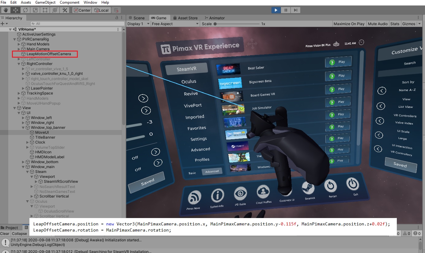

I have realized the manual adjustment of camera-offset for Leap Motion was removed already back in Leap Motion Core modules a year back or something. This explains why I havent been able to manually adjust the hand-offset. @MR-Alex
Now, waking up 7am this morning, I suddenly realized I could simply emulate a Camera and send its cordinates to LeapMotion Service (instead of using the Pimax camera directly). So I created a “emulated” camera, updated its position from the main Pimax camera, but added a slight offset to the Y and Z position.
And it works :slight_smile: No lag or delay whatsoever, positions are instantly updated.
I know its a temporary workaround until UltraLeap fixes the Pimax offset in their SDK, but at least we can get some proper hand-positions in VRExp for now :slight_smile:
I will add this to the next release, probably later today together with new fixes and stuff!
I just realized I didn’t even need to use an emulated camera. Just an empty object with Transform, getting the same postion/rotation as PVRCamera but with corrected offset :slight_smile:
Thats better, because a camera always eats some resources, while an empty object does not.

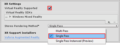

Which Stereo Rendering Method are you using?image

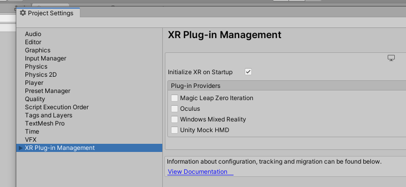

Im using none of the plugins, but have XR plugin manager active.
None of these are compatible with Pimax SDK CameraRig anyway.

But the XR Setting “VR Support” in your screenshot is deprecated as far as I know (and replaced with XR Plugin manager)?
I took it from the (outdated) documentation to be quick. Sorry.

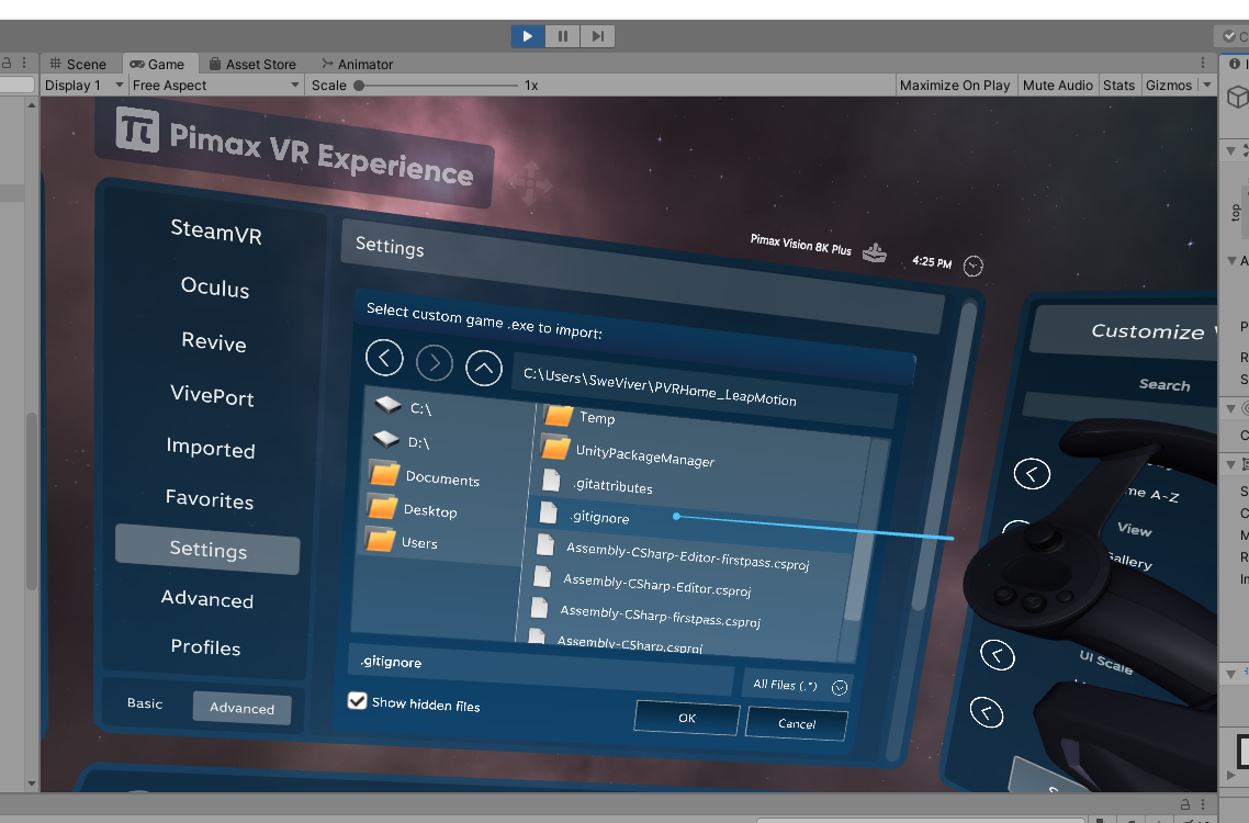

Actually, Ive been in contact with a dev and got permission to use a free File-browser script which is quite nice. Lots of customization has to be made to get it running, but Ive already made the UI interaction to work with my LaserPointer script. Shouldnt take that long to have this usable in many ways :slight_smile:
(yeah it looks ugly, layout and design will be changed)

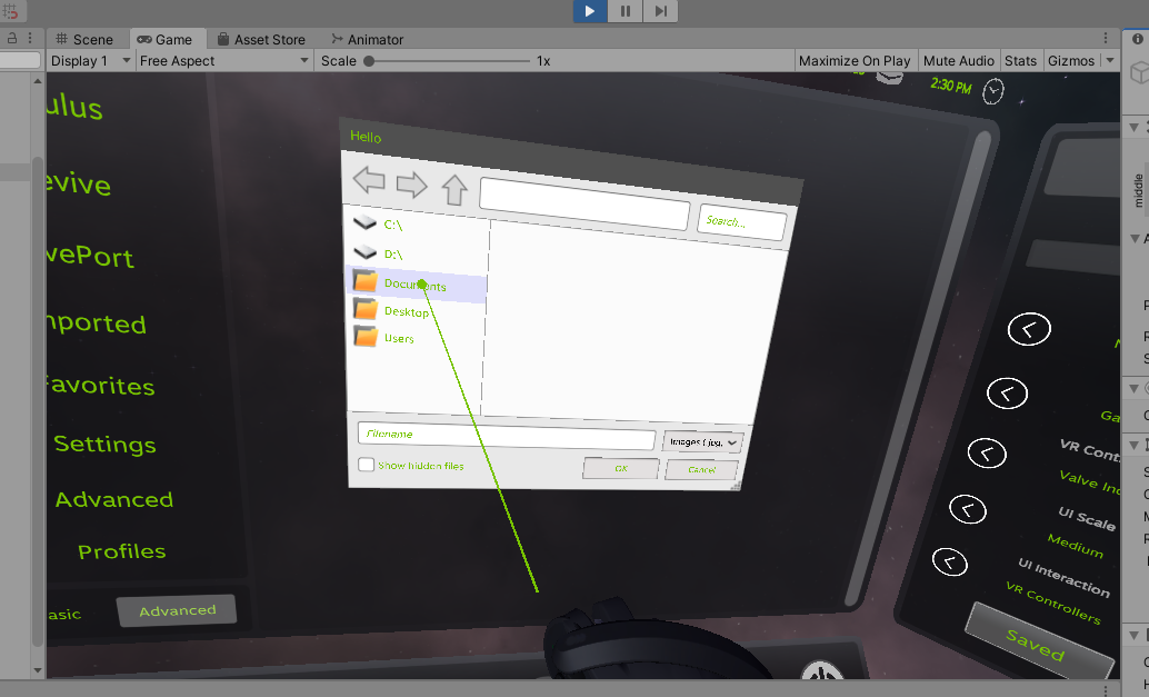

Design almost done. Having some issues to scrolling inside the file-containers by grabbing, but will get sorted eventually.,…
Looks great. Good progress.
