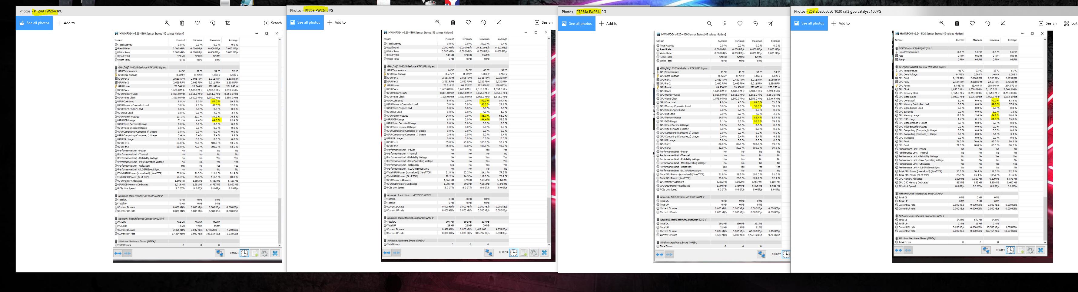

I went back to 253 with a fresh install of the tool. Weirdly, I found that
  • The GPU usage went up to 89-94%
  • The scale/FOV seemed slightly different. If felt more zoomed out (yeah, I know how that sounds)
  • The FPS seemed roughly the same in the same scenario within Elite
So I went back to the latest. Yeah I agree 76% isn’t ideal. There is a room available, i.e. maybe even +20% ish if we can hit 95% utilisation.
Definitely a PT issue IMHO

I stepped back after pitool 260 locked me in at 76% utilization.
They have to fix the later versions…
That’s a perfect example of what is happening. It’s EXACTLY what I have found. So what version have you settled upon?
253 atm
