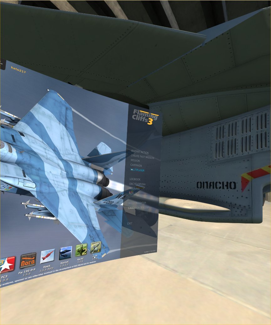

I have seen several posts here and elsewhere about how TrackIR doesn’t work in 6DOF with the Pimax. I just got TrackIR working in 6 DOF with the Pimax 4K (ver 1.2.53 and F/W 1.0.0.248) and the NON Steam version of DCS World 1.5.
The trick that worked for me is to be in “Pimax Mode”. Then open the SteamVR settings, go to the “Developer” section, and uncheck “Start SteamVR when an application starts”. Then close SteamVR before opening DCS from the desktop DCS icon. The HMD still tracks in the menu screens, but the TrackIR over rides it in game.
So now as well as pitch and yaw, we can move horizontally, vertically, and forward/back.
Also, just for reference, the menu screens can be seen fully (no cutting off of the menus).
