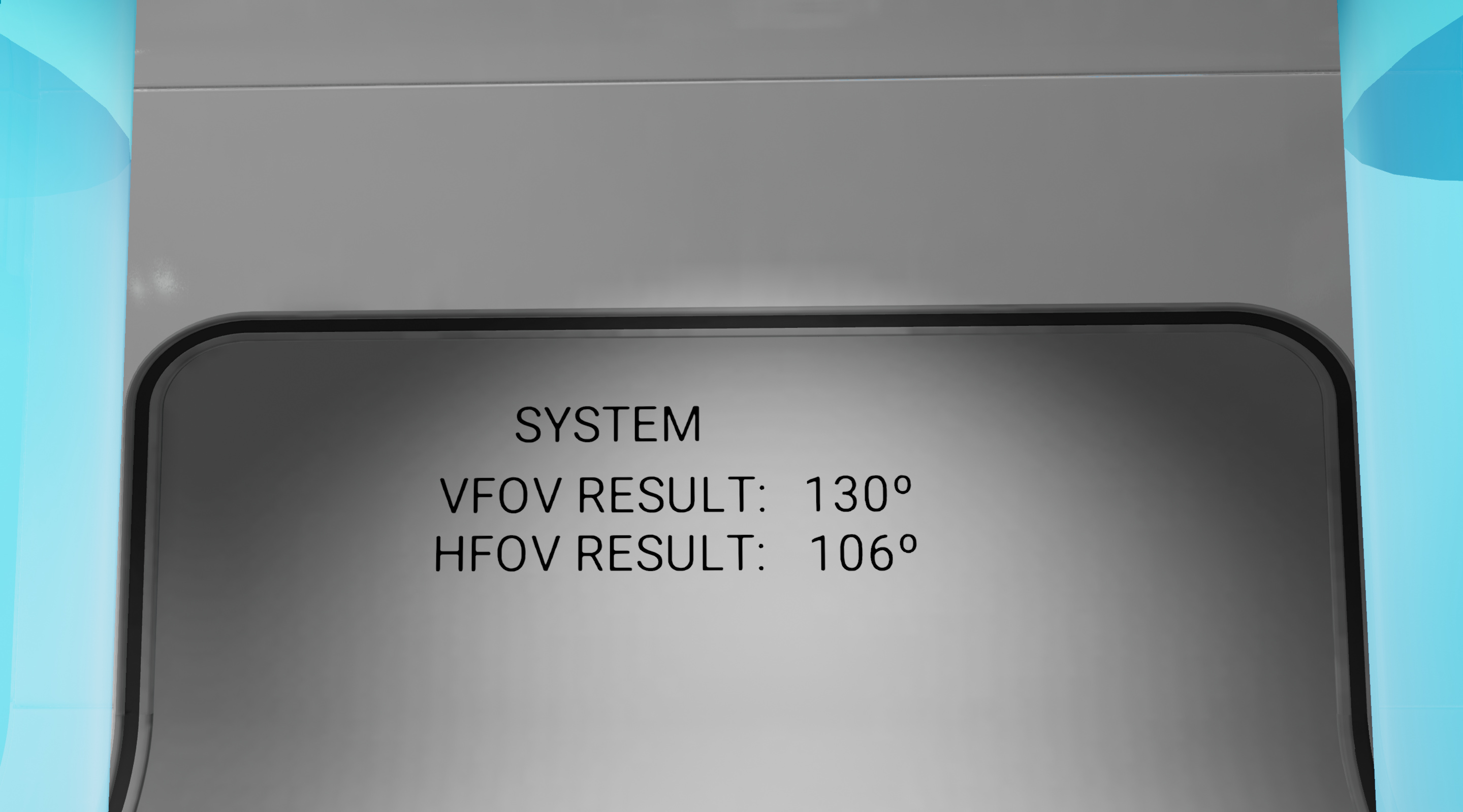

Hey guys, after seeing Sebastian’s video where he compared the FOV of various headsets using the ROV test tool, I decided to do my own comparison between the StarVR One and the Valve Index.
My optometrist measured my IPD at 63, but StarVR’s eye tracking suggested my IPD is actually 64 and it has many times measured it at 65. So I’ll say my IPD is between 64 to 65.
For Valve Index test I put the lenses as close to my eyes as possible with ipd set to 65
Pretty much the same as Sebastian’s results. For me it was 106 and for him 108 horizontal.

Valve Index Max 106°/130°
Pimax 8KX 140°/124° (from Sebastian’s measurement)
StarVR One 172°/116°
StarVR has roughly 32 degrees wider horizontal FOV than the 8KX.

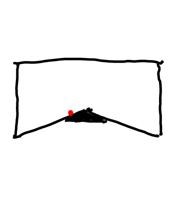

The measuring dot was really close to the bridge of my nose, but farther away from the nose, the vertical FOV is definitely wider.

I made a picture to illustrate what I see in the StarVR One. I don’t see any borders at the top of my view. I see a little bit of border on the sides and some black where the bridge of my nose is. Farther out from my nose the vertical FOV gets much wider. The red dot is where I was looking at when I measured vertical FOV…
