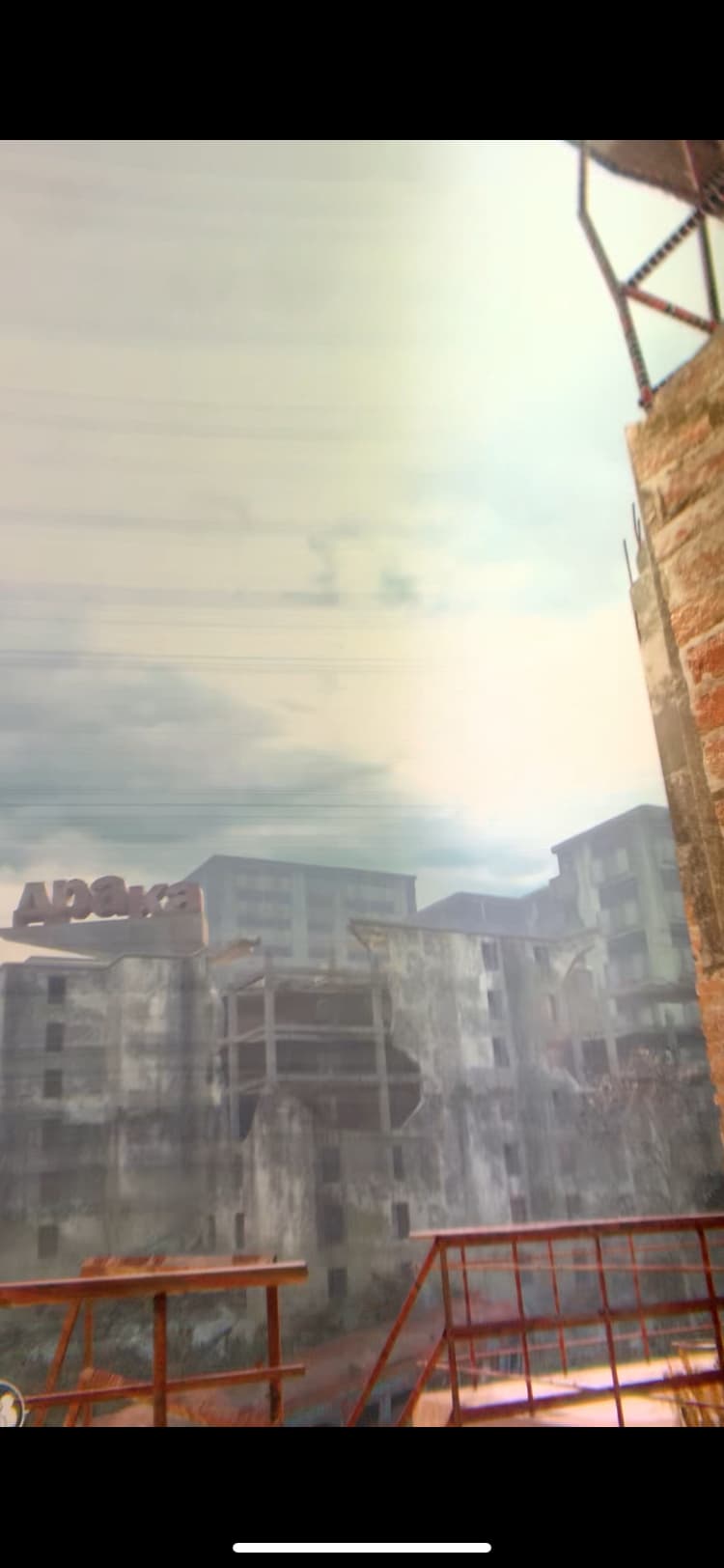

hello iv had my crystal since October , ive always shutdown thru pimax software or press the power button , and even if you dont as you crystal owners know the screens turn off, so last night i forgot too shut it down , and i went to play today and my right screen has flickering and lines across it , ive tried everything switching cables changing batteres resetting it , and nothing here i am trying to vr on my holidays now i cant very frustrating and it sucks i contacted support but there slow on returning a message
Every time I turn the Crystal on I have a garbled Right screen with grey and green static lines, like an old TV not tuned in.
It clears as soon as I press Restart Service in the Piplay app. Not sure if your problem may be similar ?
