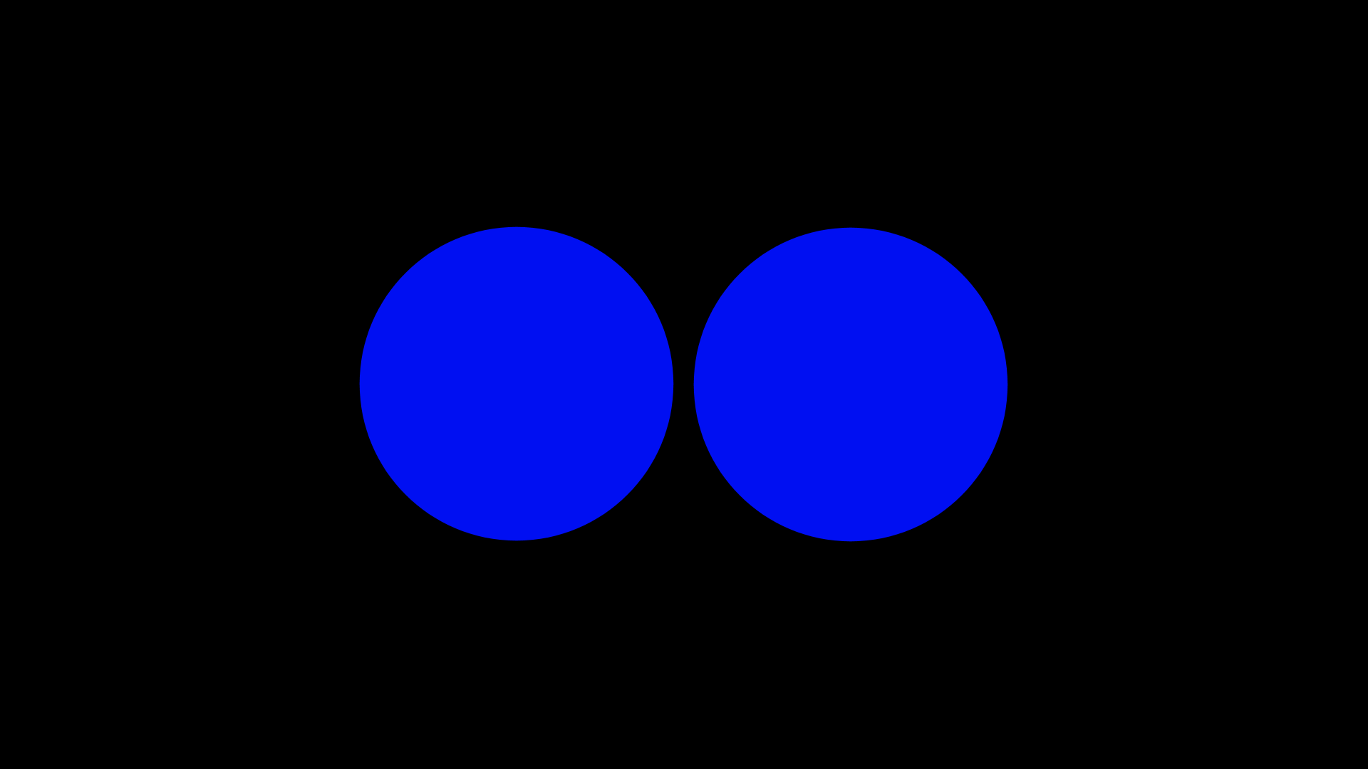

Yes, 6DOF not needed to check distortion but translation can indeed make it a bit easier to detect than rotation.
I think the most reliable way to check for distortion is to observe the deformation of a circle (= does it become oval?) when making it approaching an extremity of the FOV (left or right, but can also test up and down borders).
Also instead of turning your head you can keep your head fixed and rotate on your chair instead. I find not having your brain deal with your neck muscles helps concentrate on the circle deformation (not mandatory, as for 6DOF. Just makes the observation easier / more obvious).
You can use the “sun” in pitool environment, it is a good reference circle. If you use a specific test pattern then configuration must be set so that the pattern won’t follow head movement (of course).
I find the test pattern below gives good result. Set the zoom/distance/size so that the circles are not too big or too small (same size as on the picture is good). Then rotate (or translate) your head to make the circle(s) approach a FOV border (like right or left side). If there is distortion the circle will progressively become oval (the other circle nearby helps to have a reference). This deformation can also give the feeling the 2 circles are "getting “squeezed” against each other.
I tried stuff like that in Virtual Desktop. Distortion was not nearly as easily to perceive as just looking around in HL Alyx.
It certainly helps to have other geometric references nearby the objet you observe the deformation of.
With the above pattern the deformation is less obvious when there is only a single circle.
