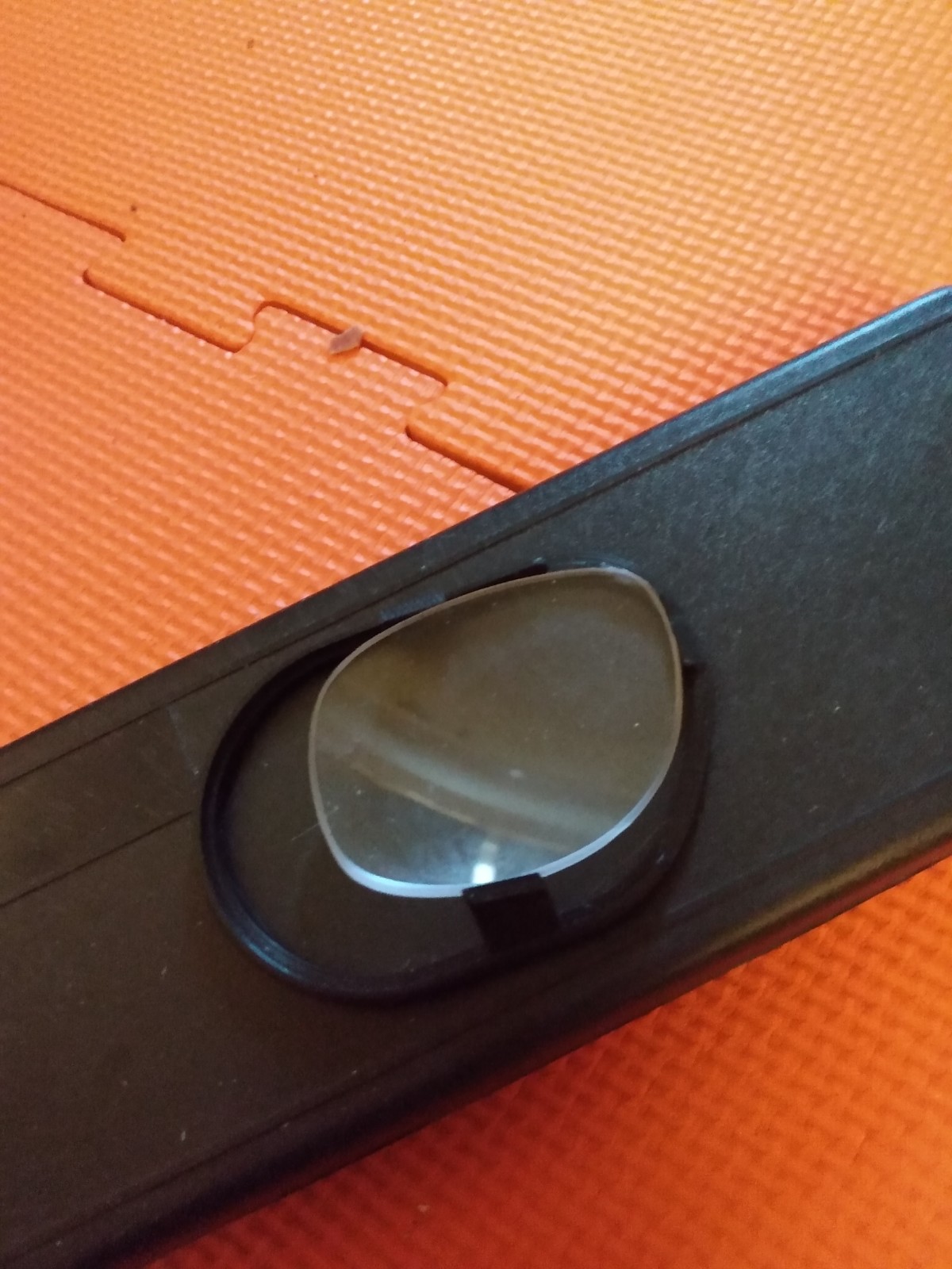

I have some lenses in a 3d printed addapter and they work fine, but I did have to get used to them. I use a hardware IPD of 60 with a - 0.5 software offset without them, but a ~61 hardware and -1 software with them. I have also found that the exact position of the lenses and their angle makes a huge difference. Before I tweaked this I did get massive eye strain in game. Not after taking the HMD off though …
It looks to me like the lenses will fit fine between the eyes and the tracker in the same sort of position as with my 3d printed ones. I do need a little more eye relief with them but it’s definately worth it and they fit fine for me. I was thinking of putting my existing lenses in the eye trackers with some double sided tape or sugru.

Some pics showing my lenses and how I think they could be similarly fitted to the eye tracker. Only concern would be the IR lights maybe being blocked, dunno. Oh also potential for extra reflections to confuse the tracking, I guess. Anti - reflective coating may help.
3d printed insert with lens :
Installed :
Extra eye relief. I used this anyway for top tilt and narrow face fit so there’s no loss for me.
How I think could maybe do exactly the same with the tracker. The camera is between the prescription lens and the tracker flat ‘lens’.
