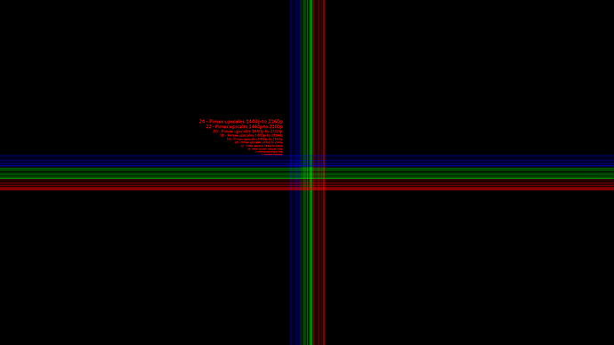

What I think would work best is like the old rear projection TVs. Blue cross left eye, yellow cross for right eye. When the 2 crosses are properly overlapped you should have a green cross with no halos of either color.

I tried this bitmap too, doesn’t work for me.
Well actually it does work but it does with several different IPD values…
Someone made a post about the fact that the lens are at an angle, I think this is the reason a simple bitmap isn’t going to work.
We need Pimax to do some serious work and find out a way to accurately calibrate our headset in real time with some tool integrated to PiTool.

  1. A tool for helping users to adjust IPD with an image similar to the line that was linked above:
