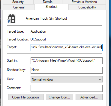

I use the method in the below link to run ATS in oculus mode so that PP is not needed.
work around for no PP in ETS and ATS
thanks a lot! ill check this out
ok, struggling a little bit.
  1. downloaded LibOVRRT32_1.dll and LibOVRRT64_1.dll from Oculus dll - Google Drive
  2. copied both dll files to ~\steamapps\common\Euro Truck Simulator\bin\win_x64
  3. created the steam_appid.txt in same folder with 227300 and saved
  4. added eurotrucks.exe in pitool and tried to start but the game is only starting in 2D and i cant jump in VR using F11
    do i have to use revive additionally?
The key is to create a shortcut as described above. Just substitute ETS2 for Automobilista. You don’t add the game into pitool, that method does not currently work anymore. You will start the game with the shortcut. What I do is just start the game from within the Desktop mode of Pimax Experience by clicking the shortcut. When creating the shortcut add the “-oculus” syntax at the end of the game exe file as shown in the below example
Capture
this was the key! now i got it working! this is f***** awesome!

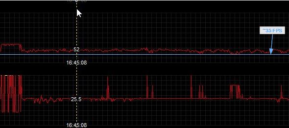

This afternoon and evening, I did some performance FPS testing in ETS2 with my 8K-X in Oculus mode (incl. FFR) vs. SteamVR.
tldr;
A) Oculus trial #1: PP Off, FFR balanced, Smart Smoothing Off
.- Noticeably less FPS (<50, avg ~45) - no significant impact or none at all of FFR
.+ Better and more even frametimes
o GPU workload 90-100% (unfortunately not in screenshot)
.+ Low GPU power consumption <250W !!
B) Oculus trial #2: PP Off, FFR Off, Smart Smoothing Off
o GPU workload also 90-100%
.- High GPU power level up to 330/340/350 W
C) SteamVR: PP On, FFR Off, Smart Smoothing Off, gpuSpeed set to 5000
.+ delivers noticeably more FPS (always >= 50 FPS, avg ~60-65)
.- worse and noticeably frametimes
o GPU workload 83-98%
.- Same high GPU power as in Oculus mode #2

Here are the graphs from Afterburner:
A) Oculus with FFR balanced
AB FPS - ETS2 VR 8Kx normal FFR balanced Oculus-mode o PP Ausschnitt - 5600X 3080 - 210511

(Besides FPS, furthermore:
Playing with PP via SteamVR shows me slight pixel sparkels from time to time in dark scenes, i.e. driving at night, but in SteamVR Home already as well when watching the black screen to the right.
I noticed, that this is completely gone in Oculus mode - absolutely no sparkles at all.)
Nevertheless, in total I think I will stay with SteamVR although having slightly worse frametimes and those pixel sparkels from time to time…
Frametimes with Oculus mode are better, and therefore the lower FPS feel more “even” and “balanced” compared to SteamVR mode -
=> …but this cannot absorb 25 up to 40% better FPS SteamVR mode provides. The whole game and driving feels more natural with 60 FPS+, and in desert or steppe locations both in ETS2 or ATS, I sometimes can even keep 70-75 FPS for a longer time.
Just wanted to share my latest experiences here :slight_smile:
