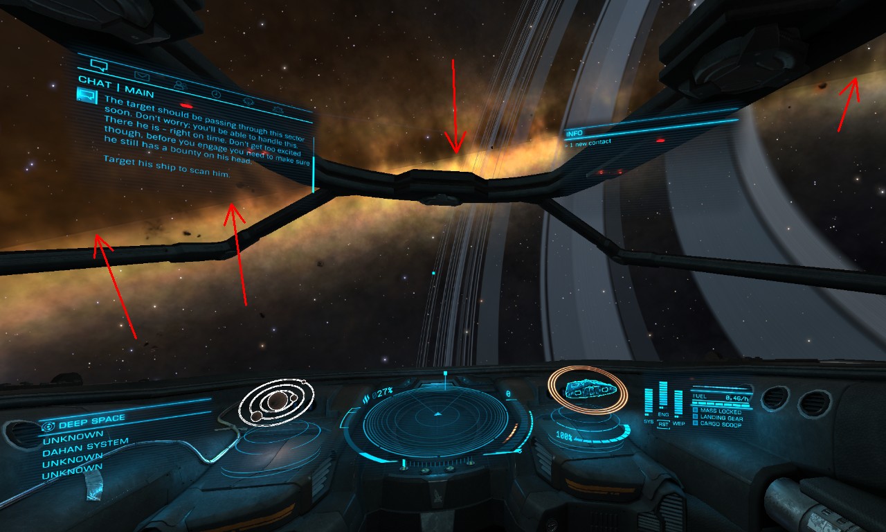

Something is off with your settings: the Milky Way has a visible ‘horizon’ where I assume different textures meet. Very jarring.
Do you mean the dark clouds along the centre line?

No, I mean like when two different textures meet and there is a sharp line. I don’t have a screenshot unfortunately, I’ll try to make one.

Managed to take a screenshot of the problem:
I do not have this issue… weird, looks to me like a shader or color banding problem
As a speed-up, Elite Dangerous uses a “sky box” to render everything outside of a system… Skybox (video games) - Wikipedia
To me, it looks like 2 faces of the skybox have 2 different lightness levels. One thing that might trigger that is insufficient video memory. (A shadow or glow map might have failed to be created.) Try reducing the render size in SteamVR or reducing the quality setting in PiTool. Another thing to try would be reducing the graphic quality settings in ED, particularly “texture size”.

While I appreciate the tip, I very much doubt it’s a memory issue for two reasons:
  1. I have a 2080 Ti with 11GB of VRAM
  2. This appeared when I applied OP’s settings
To me, it looks like a gamma mismatch between the two sides of the skybox - what might have blended in at certain gamma settings, now look distinctly different.
The issues I described could look like much like a gamma problem.
You’re right, now that I know your GPU, lack of memory is less likely. My rough calculation is that the skybox should take up no more than 302 MB, based on the OP’s parameters file. Still, it looks like the rendering of the sky box failed in some way, for at least one of the sides.
Try removing 1 or both of these sections: GalaxyBackground and GalaxyMap. You want to delete < GalaxyBackground > to < /GalaxyBackground > and/or < GalaxyMap > to < /GalaxyMap > lines.

I don’t mean to be rude but I have an overclocked 8700K and a 2080Ti. There’s something wrong with your code
Code is fine but I don’t know what else you have in ED settings , so I have no idea how to help you… :slight_smile: Have you copy this code to override file ? ( GraphicsConfigurationOverride.xml)
I’ll admit it could very well be my stupid system lol. But I copied across ALL of your code, ran ED in VR, and started experiencing slow downs. The issue was that I had also added new hardware and other software. So it took me a while to realise I’d changed to your code :slight_smile: once I diagnosed the issue, I went back to my backup file and it’s fine. Running 4000x2000 in SteamVR and getting 60fps in a dence icy asteroid ring. Maybe it’s a graphics memory issue… but after around 5-10 mins the screen would stutter, GPU usage would drop heavily every 5 seconds (90 to 10 to 90%). Unplayable for me.
